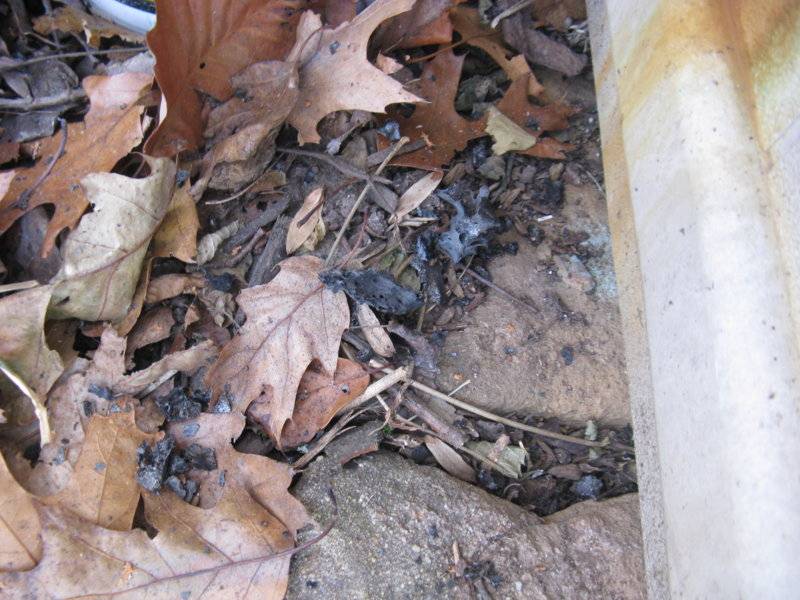

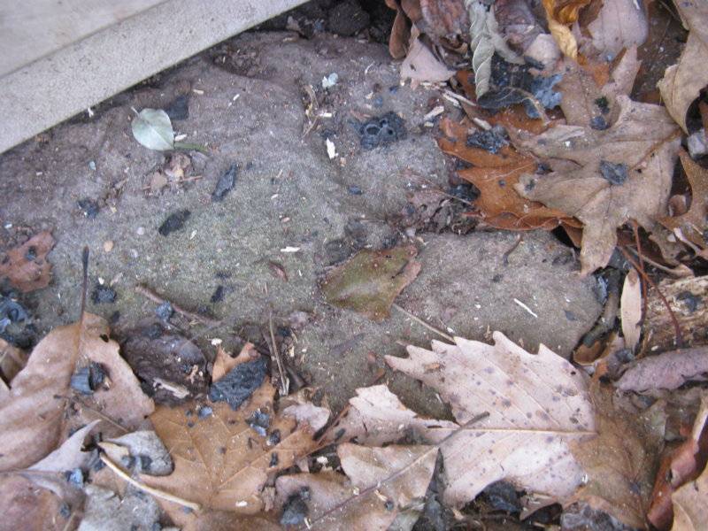

Just saw this while cleaning out some Flower beds. Last night you could see sparks/stuff spewing out the chimney and my big worry was the roof. When I walked out and got the right of our house the ground and the front flower bed you see how much stuff was floating and rolling off the roof it's very light and fluffy like black snow. Scary seeing this now as it could have caused a whole new problem while dealing with another. Glad the firemen stayed so long as these leaves were dry and could have started another fire outside, They were even walking back in the woods checking around...
