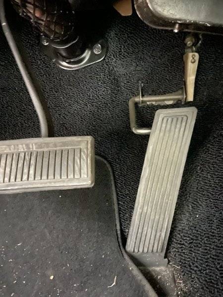

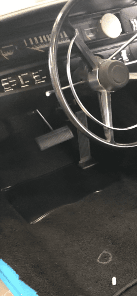

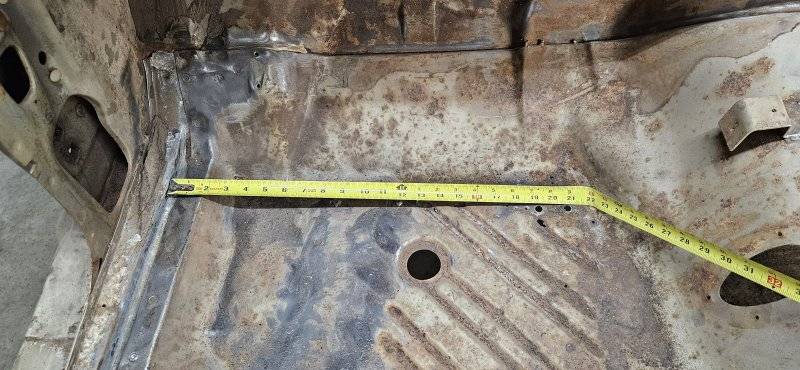

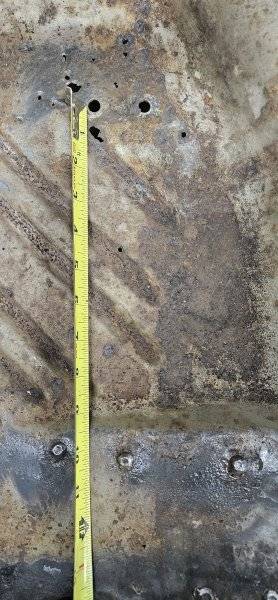

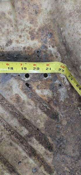

I just replaced my floor pans and I need to reposition the gas pedal and drill new holes in the floor.
Any suggestions?
No, I didn't measure the location of the pedal when I tool out the old one :rolleyes:
Just redid the floor in my 66 Charger and here are the pictures i took from the old one

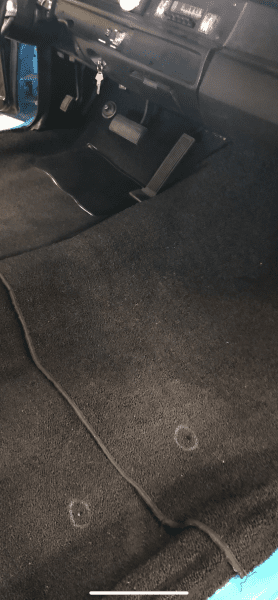

It's kind of working backwards, but the base sits at the inner forward corner of the carpet heel pad.
Cutting the rectangular hole for the pedal base is an SOB.
If mark where you need to cut with carpet in the car. Then remove it punch through the corners (make the hole for gas pedal on the small side) draw a line punch to punch mark. Cut carpet from the bottom. Try cutting a scrap piece to see if you like cutting that way.
