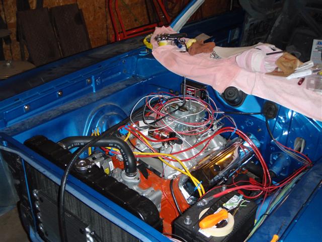

I have a 10 gauge wire ran straight through the bulkhead connector to eliminate that possibility and all the underhood wiring is new as is all wiring and connectors that complete the charging circuit. This is a complete resto-mod on a 10 second full interior, full body street/strip car.

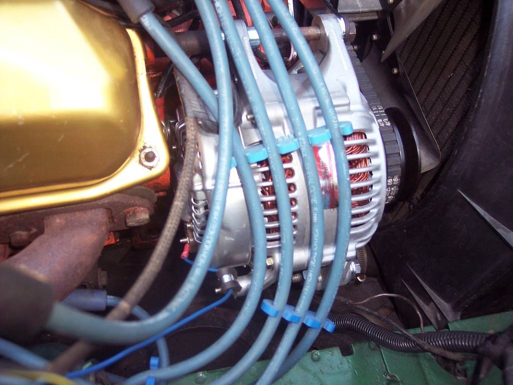

I got the Denso 210 0138 - 120 amp installed tonight. It was much easier to mount than I had anticipated. I used the factory alternator brackets but the adjustment is all the way out and the belt is tight for now. I might need a belt that is a couple inches shorter in the near future. I had to use ring terminals for the two field terminals as opposed to the spade type connectors and I had to modify the plastic isolator that is around the output post on the Denso to allow clearance for the factory gang wire ring terminal and the added 8 gauge wire ring termianl that is routed to the starter relay. I bought the alternator that is claimed to be new ( it looks new) for $35.00 on E-bay because the output post had been shortend 1/2 inch which is ok because that modification was possibly needed to clear the head. The alternator charges at idle as claimed. I had everything powered up including the headlights on bright, (man are they bright) and the voltage is 14.25 at idle! I think the engine is more responsive due to the increased voltage! I haven't taken the car out yet for a long drive but for now I'm thinking this could be the best upgrade I've made to date.
I have now taken the car out on extended cruises with no issues. I highly recommend this upgrade if wiring has been upgraded as mentioned in my previous post within this thread. I love it!!!
440 Mopar with Denso 210-0138 120 amp alternator that does a great job at idle.
This is the best pic I have.
WTF....
I Would start over with the wireing and the transmission cooler lines..... check out madd electrical on the web.... unless you have a trunk full 12" speakers and amps a 75 should be ideal. I'm going to run a 140 amp powermaster.... the car will use 50a max and the stereo has 90a and it won't use all of it so the alt will run cool.
