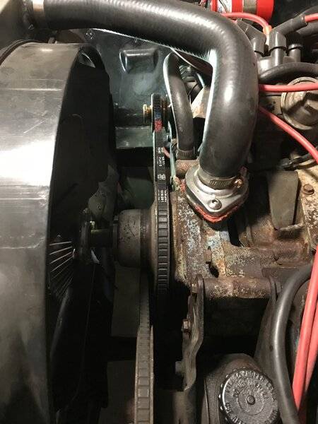

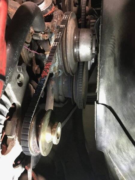

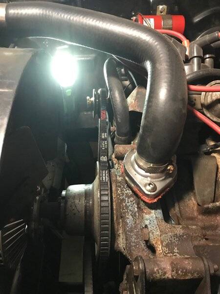

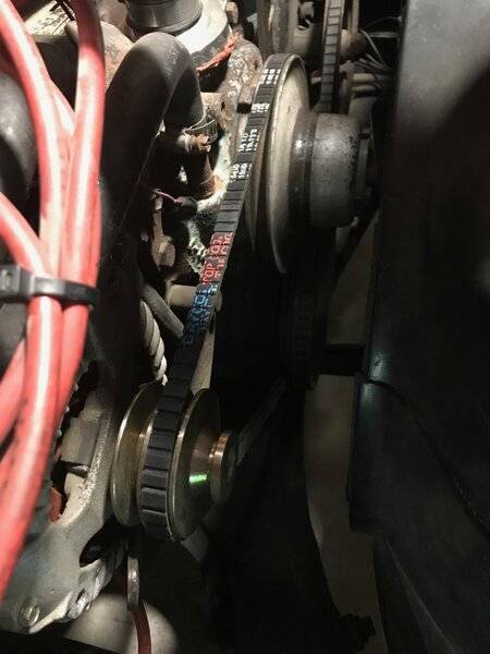

Yep for sure; here below the current setup with the belt on the external groove respect to the engine; and I also post pictures when belt is on the internal groove respect to the engine (with the new alternator it would be like that)

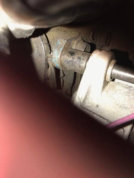

I also put a picture of the bracket I currently have for the upper pivot bolt, I feel it very dangerous because I can overtight the bolt and touch the engine block if I want.... Is it really normal ? :-/

I noticed there is no spacer on the pivot bolt between the mounting "ears" on the alternator. That may be part of the problem? ruffcut
Ah no its just to make it quick for the picture I have removed it, but on the new alternator (not on the picture) there is one, for this no issue
but once I put the new alternator (tuff stuff chrome one) the belt is on the position like the engine side groove and you can clearly see the misalignment like on the picture I did for the example.

I believe your problem is the style of the double groove pulley on the alternator.
If you look at few factory double groove alternator pulleys you’ll see the difference.

I always like to use a straight edge across the water pump pulley to the alternator.
Sometimes shim the alternator, sometimes the bracket from the water pump.Or both.

No sir I would get the alignment as close as possible either by shimming as Darter6 recommended or get the correct pulley.
There is a slight amount of misalignment ok with a V belt but i would get it as close as possible.
It looks like the alternator mounting brackets are the problem to me? Looks like the lower one is for an a/c style? Kinda hard to see in the picture.
As mentioned, there is different bracket set for the non-A/C single groove alternator mounting. The dual groove Alt pully is for A/C applications. You have a mismatch of parts going on.
