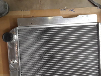

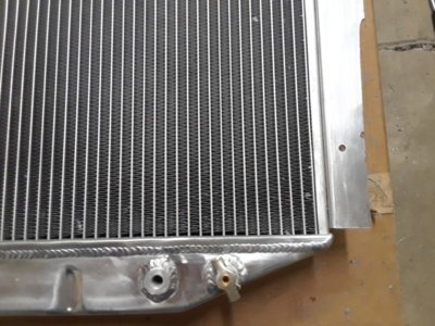

View attachment 839945I bought this off ebay. it is not OE but is a very nice OEish alm replacement rad for the money, and fit perfect! couldn't happier with it.

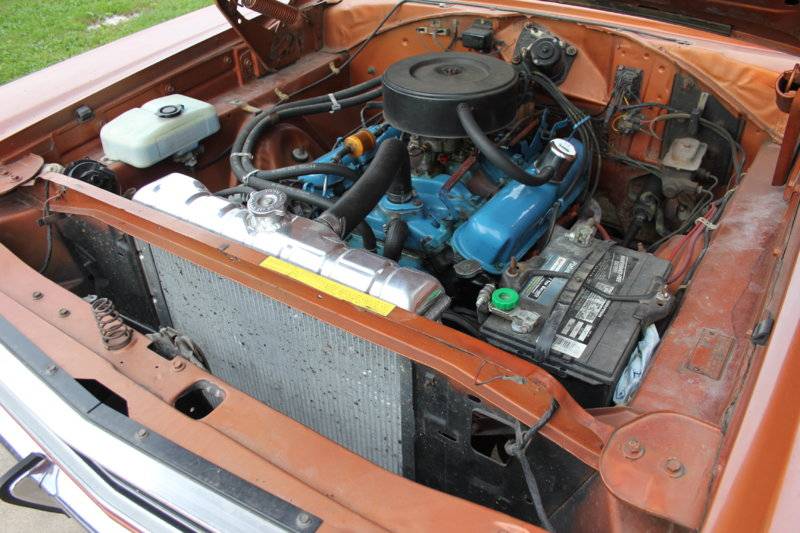

Sorry, I've been sleeping. LOL 3 row. and No over heating. but to be clear mine is a stock 318.

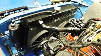

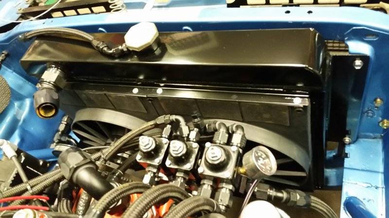

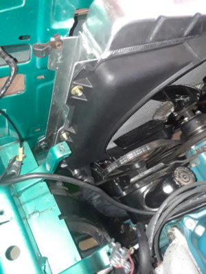

I had Superior Radiator here locally make me a custom radiator for my 70' Challenger. Bolted right in, came with 2 high flow Derale electric fans. He also added -20 AN weld on bungs to run my -20 hoses top and bottom. Good for up to 1000 h.p.
