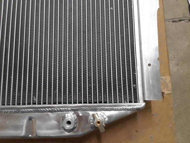

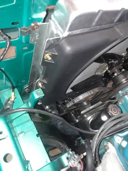

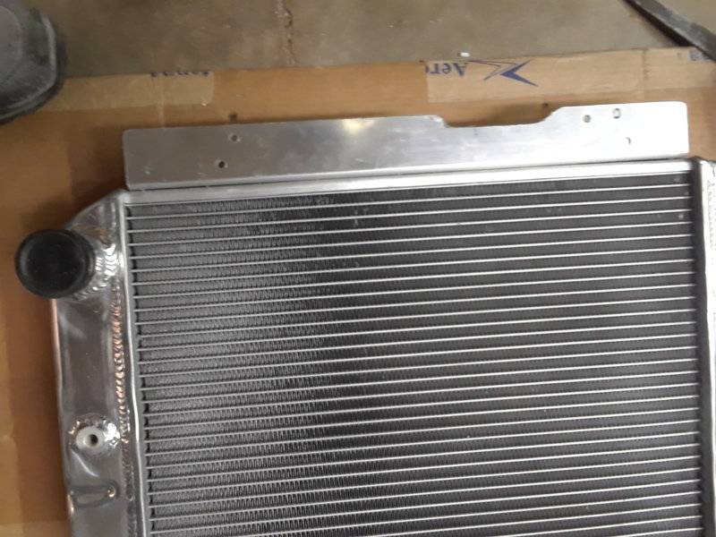

I must have got a different radiator. You are the second forum member to say fit without mods.
I had to grind in three places, file the mounting holes, and barely had enough meat to mount the shroud.
View attachment 850709 View attachment 850710 View attachment 850711
That's what I had to do as well...

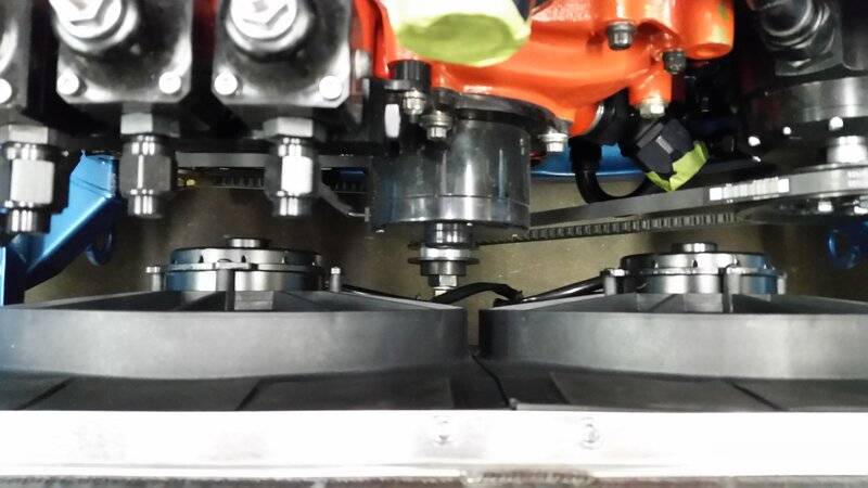

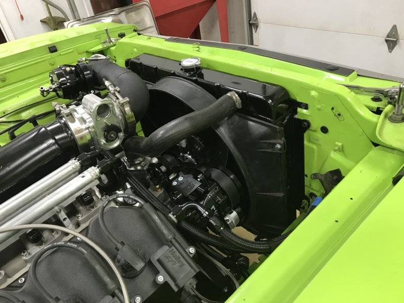

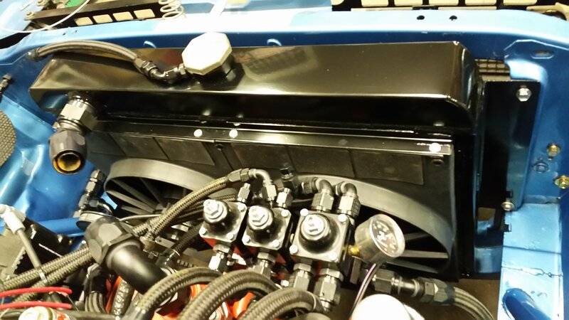

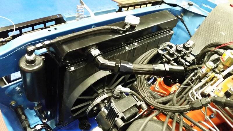

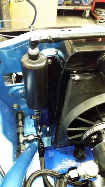

I had mine custom made and it bolted right in. Dual Spal fans and -20 AN bungs for hose end fittings.
20161118_201142.jpg 20161201_200820.jpg 20161124_181756.jpg 20161201_200808.jpg
