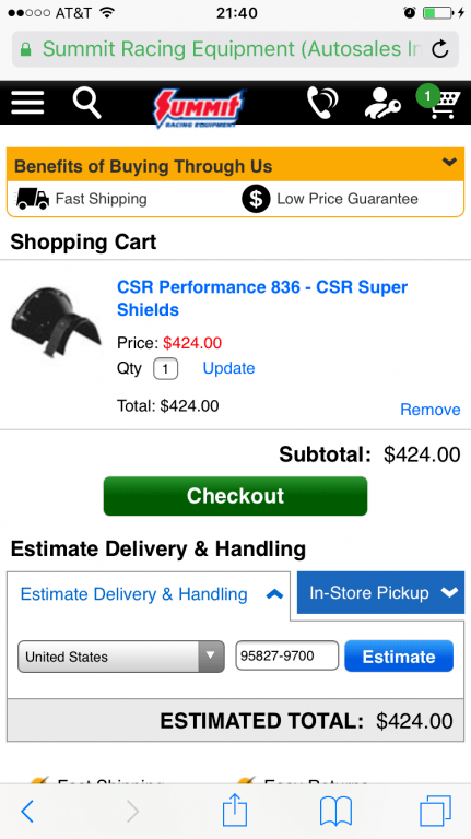

I plan on using the CSR shield that is a complete cover
CSR Performance 836 - CSR Super Shields
What's YOUR price on it?
