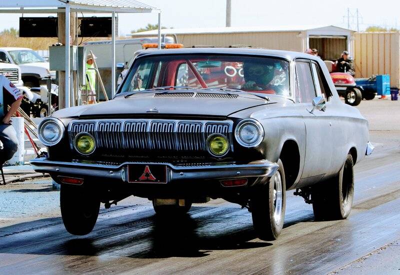

I traded for a set of Stealths a few years ago that were brand new. Sent them off and had them CNC ported. I decided to run thick wall 5/16" Manton pushrods. In my experience, at this level the 3/8" pushrods aren't necessary. Zero issues and my car is rhe poster child for abuse! It goes to the track almost every weekend in the Summer and gets driven a LOT! Been a 10.0 and quite a few 10.2's.
