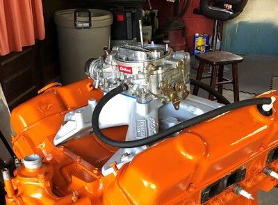

I did this one with glass beads.
Many years ago I used glass beads to blast an Edelbrock aluminum intake then used a really fine flat file on all the lettering. Really looked sharp!!!!
