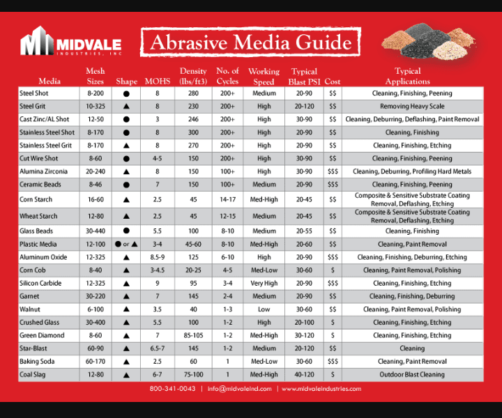

U R the best Leanna. KimWhat you're blasting and what you're trying to remove should guide your media choice.

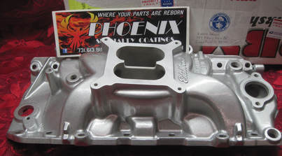

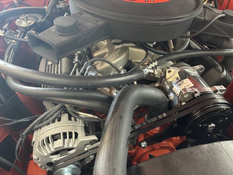

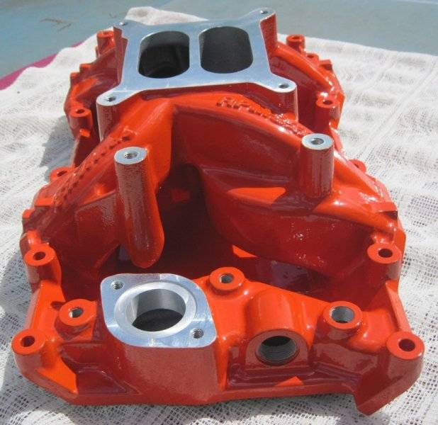

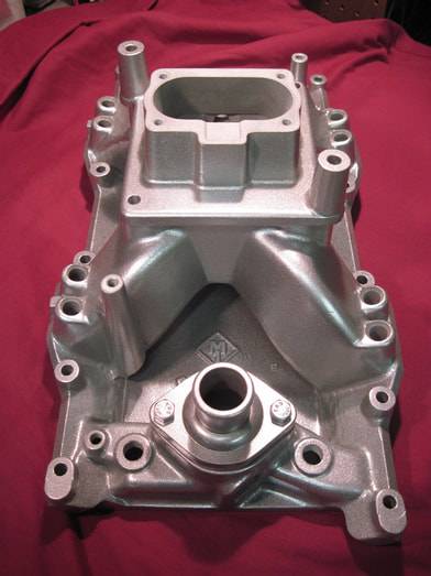

Quite a few of you gentlemen sport intakes I've restored/finished for you, several almost two decades ago now. How is it holding up to use? Any new staining or a resurfacing of old stains? Any issues with the clear on silver ones? I'd love to know!

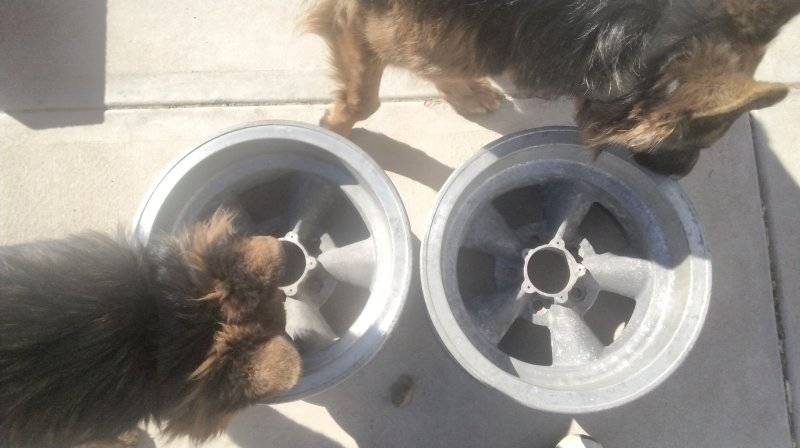

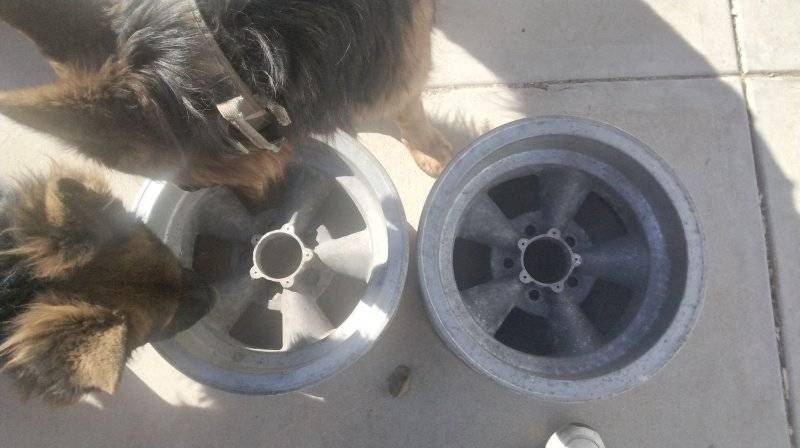

Curious. Would you all use the same media you use on an intake on a pair of natural finish aluminum wheels?
(Seventies vintage Ansen. I have new ansen caps, and gonna have the lips repolished)
