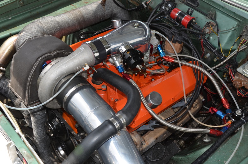

E19.jpgIMG_7816.JPGracecar 474.jpgSingle stage Urethane out of the gun over epoxy primer. It will never flake off. Gas won't hurt it. I've got some engines that look this good that I sprayed 15 years ago.

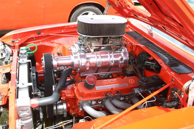

Is that the infamous Rat Roaster? Looks awesome dvw and the M/T's look pretty old school cool too. Any more you've done?

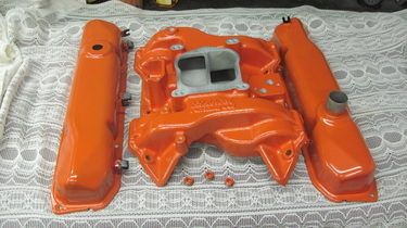

It's an Indy cross ram. Very similar to a Hemi Rat Roaster. Spray bomb comparison. This one looked good until jet changes allowed fuel to spill, killed it.

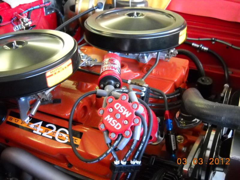

That looks fantastic, Doug. The only problem is that the average guy in his home garage doesn't have the equipment or talent to do what you did. Again, if you need a show car finish, take it to someone like Doug to paint or have it powder coated. I've done it the way I've outlined for many, many years and always get compliments on my motor. BTW, I use Duplicolor engine enamel.

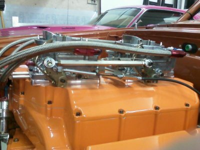

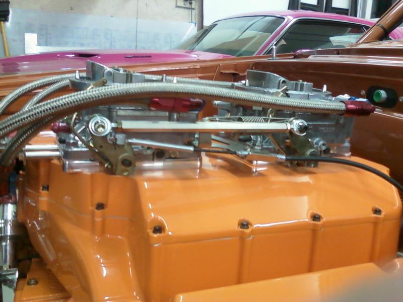

Ah , but this was done in a home garage. Cheap spray gun and urethane. Not done in a booth. I used spray can for years, just not as durable.
