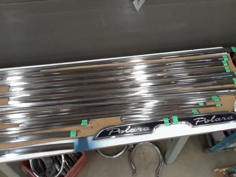

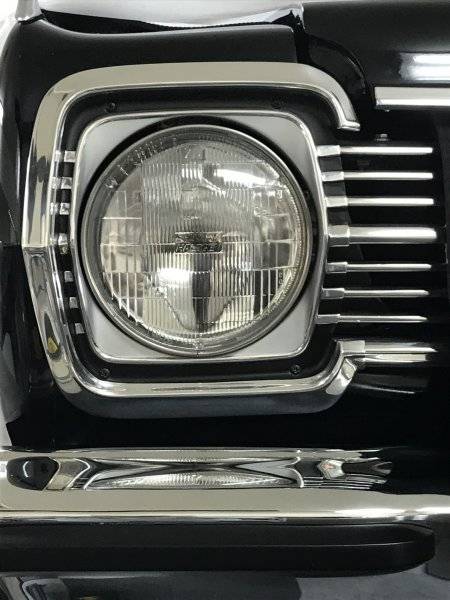

Maybe a little off topic, but 2 years ago I reconditioned / polished every single piece of trim, with the exception of pot metal pieces, on my 64 Polara. I spent about $300 on supplies. It took me about 30 hours to do it all. This included dent removal, removing any anodizing etc. I also painted areas that were finished as such from the factory. Finished result was in my opinion, was a 9.5 out of 10. I had no prior experience doing this. It was my first stab doing this. It's a little nerve racking taking #100 sand paper to aluminum trim, but in the end, if done correctly, the results are worth it. A couple of pics for reference.
Before
After

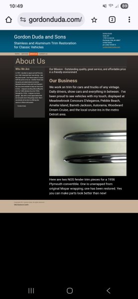

I used a local gentleman by the name Gordon Duda. He is retired and does it on the side. He has done numerous Autorama show cars. He is a very nice guy. Quick turn around. Reasonably prices. He did 11 pieces for me for $300.00. Looked great when done.
