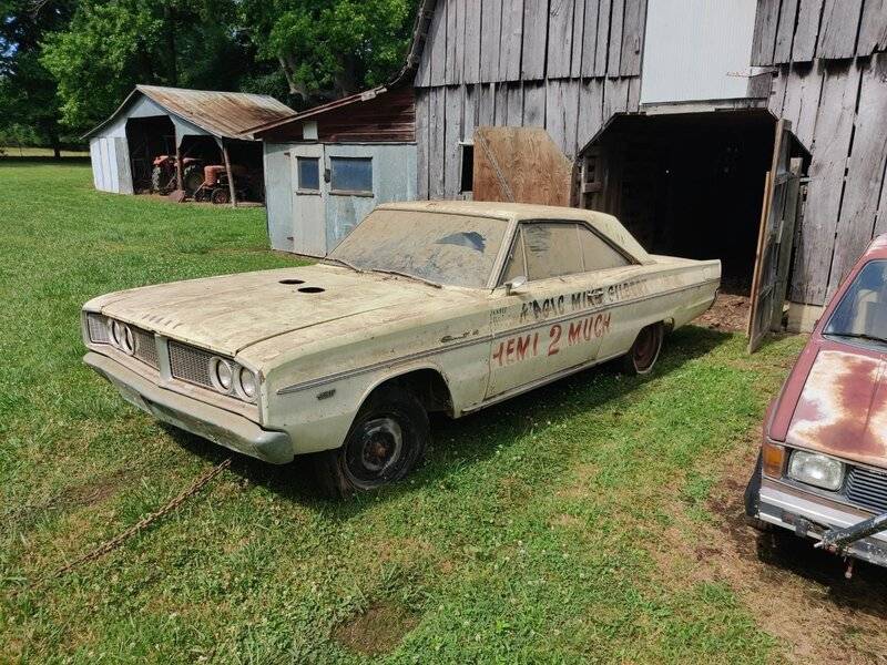

1966 Dodge Coronet 440 426 Hemi. 9500 original miles, One owner ( Other than myself )
Former drag car from new and has been sitting up since @ 1970

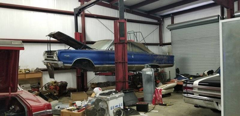

First off, its your car. It will never be worth anymore than you make it. I like OE for the most part. I'm doing a 67 Hemi 4-speed Satellite clone my way and on a budget. As far as your list goes:
Distributor- MP Performance electronic
Brakes- Dual Pot MC & lines Disk or 11" Drums
Alternator- period correct round back
Radiator- Glenn Ray or look alike Aluminum the look alike aluminum can be bought for as little as $229 and with a little chassis black it will look and perform as stock.
Manifolds- Reproduction
Starter- Rebuilt standard Chrysler not the expensive direct drive unit unless you still have it.
This is just my opinion and most of what I will be doing on my Satellite. I already have most everything I will be using except a 66-67 Dana. The car was previously a 383 4-speed so I will be adding a lot of the US Car and Tool torque boxes, and other frame strengthening parts. The body is going to be cleaned up and the patina kept. Going for the worn street brawler look and a driver that no one will think twice about. Oh they may think get that junk off the road. :)

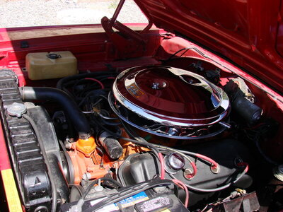

My '68 Hemi GTX was restored, and owned for 31 years by a gentleman who leaned toward stock, but not concours. For example, he did away with the stock dual point, and replaced it with a 1980s electronic ignition. Tires are Goodyear radials, not OEM. Original numbers matching engine was rebuilt totally stock, not even hardened valve seats. Undercarriage was painted close to stock, but more body color, rather than just overspray, but still shows some primer. Radiator, manifolds, and carbs are original. My automatic car has the 8-3/4 rear, original 3:55 was replaced with a 3:73 (I assume not an option with the Dana) I love the way the car drives, and would never change it from current form. As the others have said, ultimately it's your car, and you should do what works for you. I had two 1960s Imperials with the single pot master, and agree the dual is a good move.

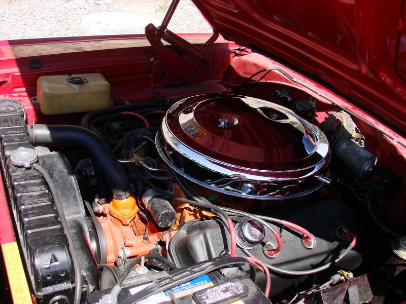

600HP in this one. I like the stock look. I like your period speed parts but if you have to buy a radiator for instance, spend the $$$ on a stock one with the correct # on it. Those $50 Chinese aluminum ones stick out like a sore thumb.

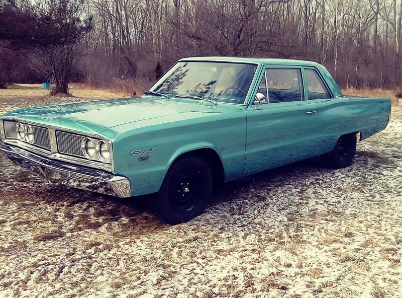

I also like period correct racing parts so long as they are able to deal with street driving. It's something that shows the car's heritage imo. Raced since new.....that says a lot about what happened to several of them back then but how many are still wearing their racing trim? I assume it's a hard top? Don't know if the 440 was available in a 2dr post model or not...
