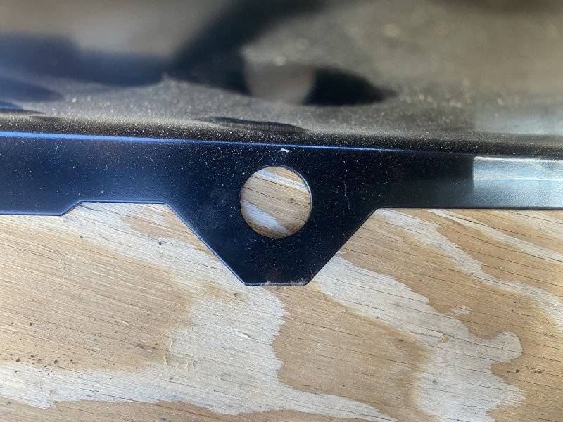

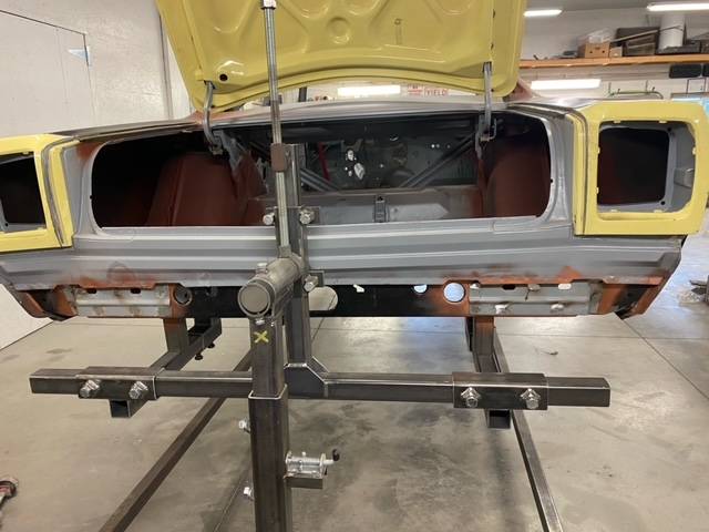

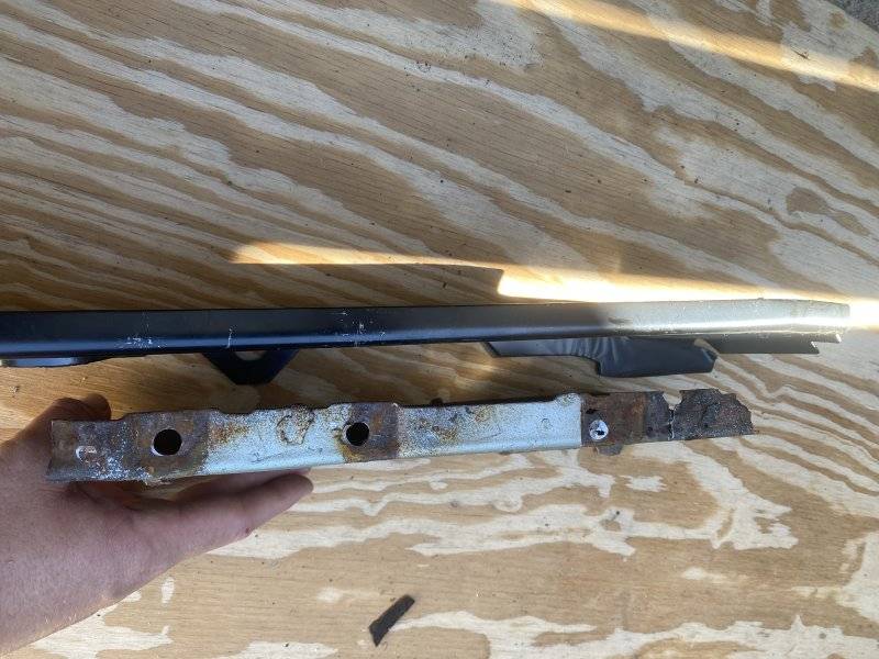

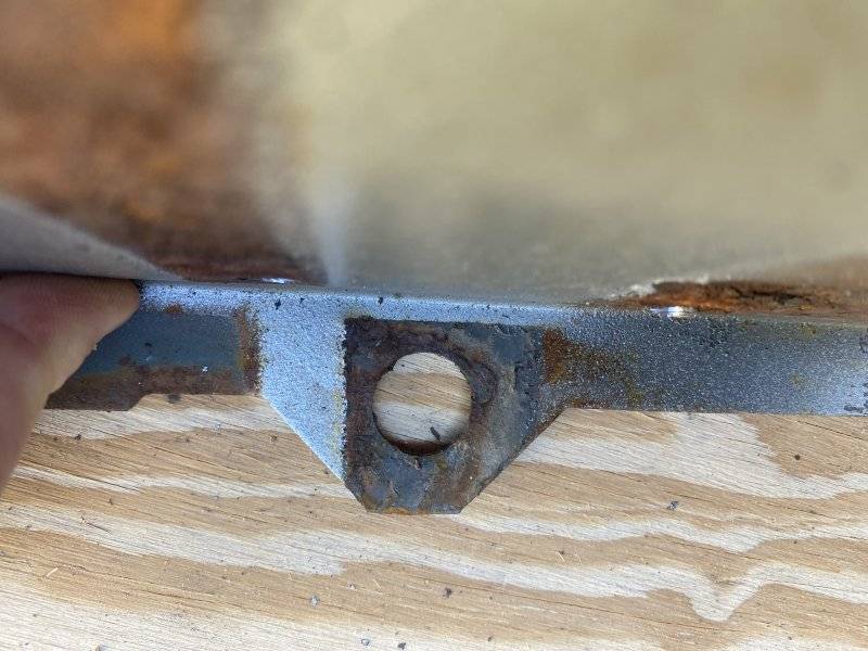

I have the rear frame rails braced and have removed the crusty old crossmember. I just mocked up the AMD version, and it doesn’t seem quite right. The flange at the top is noticeably shorter and the bolt holes in the flanges below seem like they are closer to the panel than on the original.
Am I missing something here? The part number shows it being the right part.
Any input from someone who has done this?
I just went through that same exercise. For all the claims they make they still crank out inaccurate ****. After cutting out all the spot welds I had to first fill them all back in because the flange on the new piece isn't wide enough to cover them.
And the oblong holes are gonna need trimming too.
Oh, and the flange in the stock piece is also dimpled (for lack of a better term) where it overlaps the tabs on the ends of the frame rails, whereas the new piece is not. This will prevent the new piece from sitting flush up against the floor. You can dimple the new piece or cut the tabs off the frame rails.

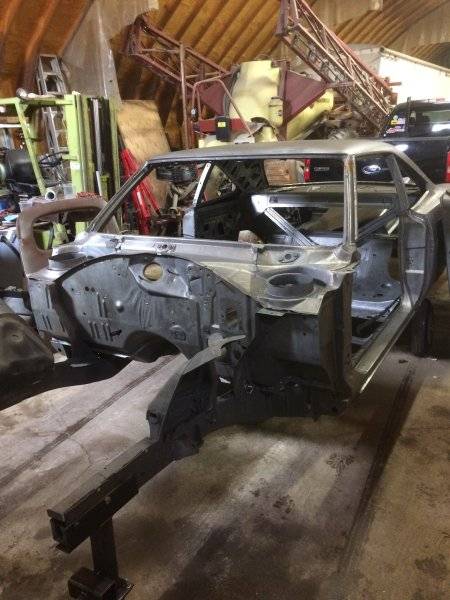

Just in case you think "dipping is the be all end all !!!
This is the piece fully installed - including new end pieces which weren't too bad. I was able to reuse the original support brackets after blasting.

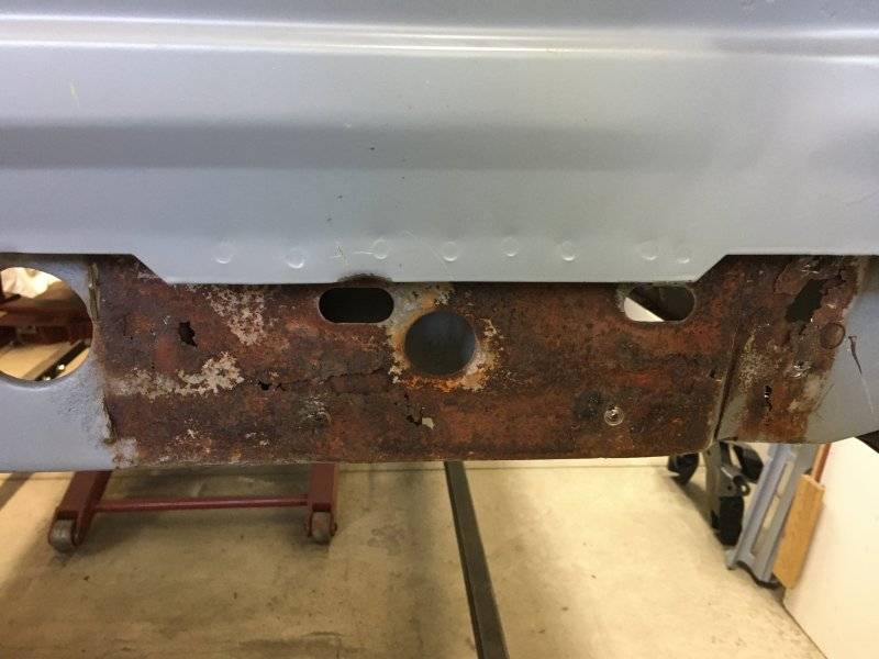

Here is one with the welds mostly filled - there are a couple that are a bitch to get at so seam sealer will play a role.
I take credit for cutting out the old, filling the holes and making the flange dimples. Then the phone rang and it was the bodyman/painter saying he was ready to take the car. He did the install and did an awesome job.
How did you make the flange dimples? It seems like a pain to shape there being that it’s right on the bend.
I cut slits the width of the dimples in the flange then flattened those pieces out then rebent them where they needed to be then mig'd the slits and ground them into shape.

The holes at the bottom of the cross member are clearance holes for the bumperettes.
I don't remember any issues with mine, but then it is not done.
We haven’t been discussing the bottom but the holes the op is referring to are where the bumper brackets bolt up into the frame on a b body (not sure about charger) and there is “wiggle room”
