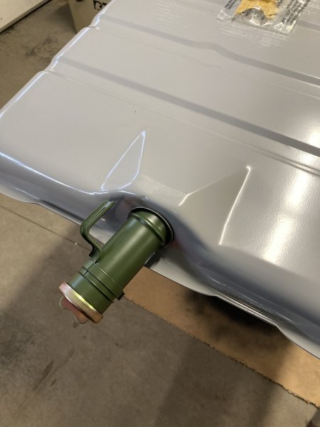

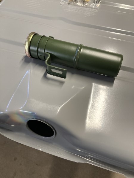

Alrighty then……seem to be missing something here…..parts manual shows a grommet and a locking ring for the filler tube……and I’ll be damned if I can find them!!! Anyone have knowledge of these???? Btw……this is big, as in, the whole rear end rebuilt…..first part going on that doesn’t include welding!!!! Big!!!! Huge!!!! Light at the end of the tunnel!!! Small light, but none the less…..parts going on as opposed to not cutting and welding…..whaaahoooo!!! Thanks for help in advance
Soooo…the grommet hold that in place? Goes on the filler tube lip about half way down? I assume the backer mounts to something??
The seal goes into the tank opening and the filler tube slides into the grommet. I assume this backer thing you are talking about is the filler tube support bracket which should mount to the rear frame crossbar. You should have the FSM.
This what I have…..slot for the bracket lines up with new crossmember. And that grommet sound “tight” if it hold that seal….alrighty then, thanks mister!!!
Panora - “slides into grommet “? Lol, not an easy slide! But ur correct.
