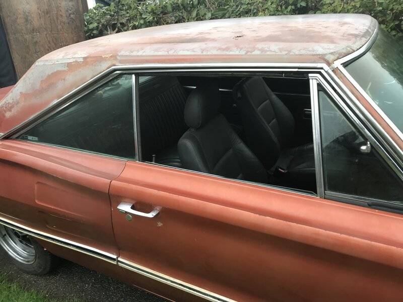

Hi all, despite a quick search I didn’t find info. I’ve recently acquired a ‘67 Coronet 440 and wish to add modern seat belts. My question is, has anybody been able to fit an anchor on the B pillar area or does the rear side window glass/mechanism prevent this?
You have a hardtop, so it’s pillarless. The only way you could do it is to swap in a modern bucket seat assembly with seat belts built it. But make sure your seat is mounted correctly and doesn’t have seats just mounted in sheet metal. Imo

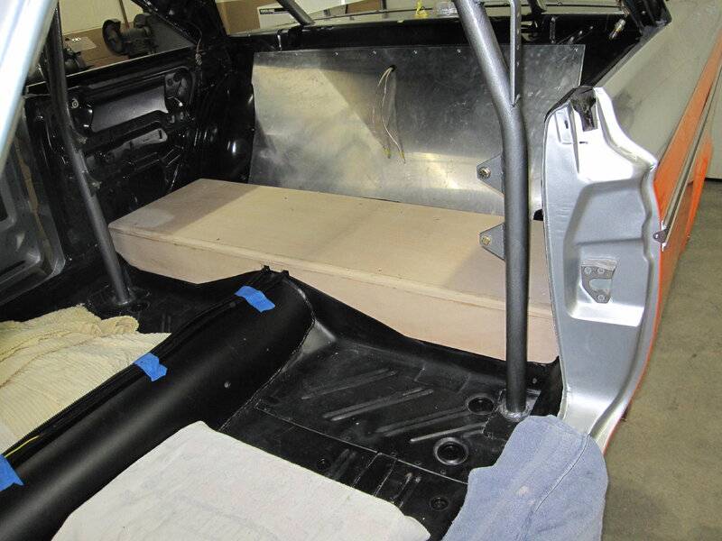

If you add a roll bar it's pretty easy. When I realized how very little metal was attaching the roof to the body I decided I needed a bar.

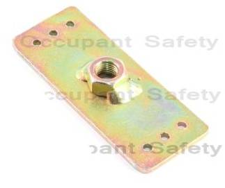

If you want 3 point fixed belts instead of lap belts then it's easy. I did it myself recently, no welding required. You do have to remove the headliner first - drill a hole larger than the anchor bolt diameter and there's enough room to slide the anchor plate in behind the inner roof structure and then bolt the shoulder attachment bolt in. I siliconed the anchor plate to stop it moving if the bolt is removed (if you removed the bolt once the headliner was back in the plate would drop out of position) , but the silicone is obviously not structural, the integrity of the attachment point is from the bolt/plate. I can post a photo later that shows the exact location to drill the hole. I used a local seatbelt supplier so no shipping costs and compliant with local regulations.

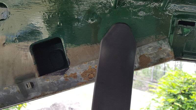

The below picture shows the location point for mine. The anchor plate fits through the convenient hole to the left. I put a few dabs of silicone on the mating face of the anchor plate ( I put the plate in flat side in with the nut side facing the outside of the car), then held it in position with my hand while I bolted the anchor point in. The bolt hole I drilled was about 3/8" I think. Once the silicone goes off you can remove the bolt and the plate won't move. It would only be an issue once the headliner was back in as there would be no way to access the hole.
There is one of the reinforcing hoops that form the roof structure right near where I located the anchor point, so there is decent strength in this area.
