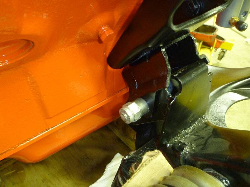

Mine haven't failed in 42 years... :thumbsup:
I only use urethane transmission mounts. Much stiffer than the rubber mounts. 440'
Lol...
Those are solid steel mounts, right?
