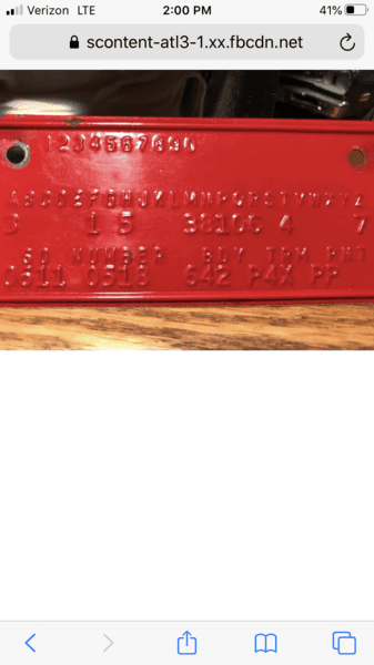

Just picked up another 64 Polara 500 and was hoping for a little help decoding the fender tag, as it’s a little like trying to read Chinese. I know it’s a factory four speed car and it currently has a 440 in it that is not the original motor. Previous owner thinks it was a 383 car but he isn’t sure. Any help would be appreciated. Thanks
VIN 6442237087
A 3
F 1
H 5
M 3
N 8
P 1
Q 0
R 6
T 4
Z 7
Fender tag also attached as image.
A3 is 4 speed, F1 is am radio, H5 is heater, M3 is backup lights, N8 is windsheild washer, P1 is outside left mirror QR 06 is 383 4 bbl. T4 is 70 amp battery, Z7 is a don't know. 1964 polara 500 2dr. hardtop, painted red with black bucket seats, and with a scheduled production date of June 11, 1964, at the Hamtramck assembly plant.

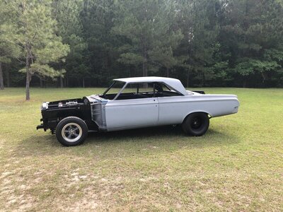

Here it is. A little bit of paint work and it’s ready for reassembly. TON of new parts, to include all new interior. I’ll add AC and this one will become my daily. My other 64 500 will be the toy, once it’s finished.
