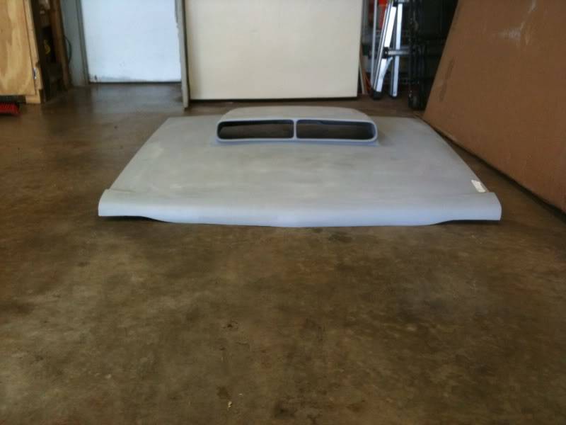

I'm starting to think no one can make a 6 pack hood right for my 68 Dodge Coronet.
First company, as bad as there QC was, they took back the hood and gave my money back after I email them the pictures.

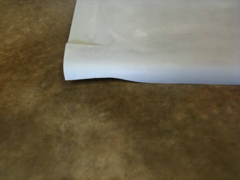

Now Company #2 from California lip like it going on a Dart. After calling them, the to also take pictures and MAIL them, no email. So now I get to play the waiting game
I am giving them a chance to make it right before I start putting names along with their product and poor customer service.
Is their such a thing as a good fiberglass part? Some are better than others for sure, what's the main problem with this one? I see from your pictures that the edges don't look great, but most glass parts need filling and smoothing.
I think that hood is cast for a '69. The factory hood on a 68-9 is the same, but for '69, they added a filler piece to close in the grille. If you want, take some measurements, and you may find that you can make a straight cut across the bottom front of the hood, and it will work on your '68. Odds are they cast it for a '69 so it will fit both years car with slight mods.

If you have a 69 grille and there isn't an opening along the lower section as well, they've also changed the lower valence. The '68 valence runs straight across because the 68 grille is the same width from side to side. The 69 grille is thinner between the headlights.
If I remember right, the filler piece is made out of like pot metal, and on some models, like the 440, it's polished to add more pop. I do remember it screws on from the bottom.
I measured it, and can cut off and straighten it out.
There is other things not right with the hood that not there like the center ridge and the whole front top is flat where it suppose to be raised then dip down.
