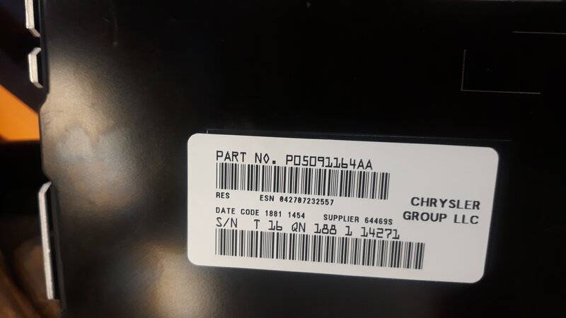

Code on the radio face says its RES .
does said radio require an amp ?

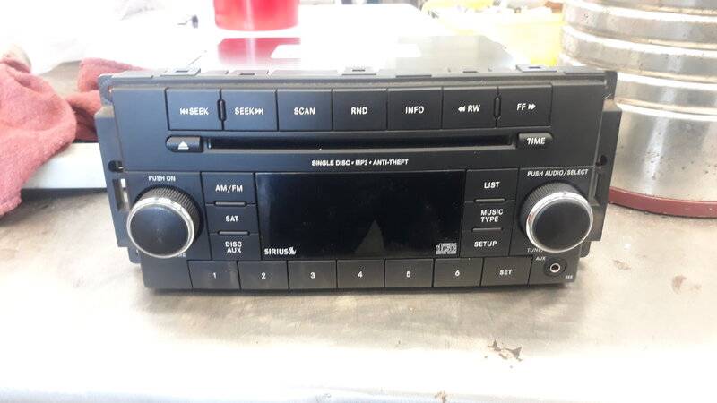

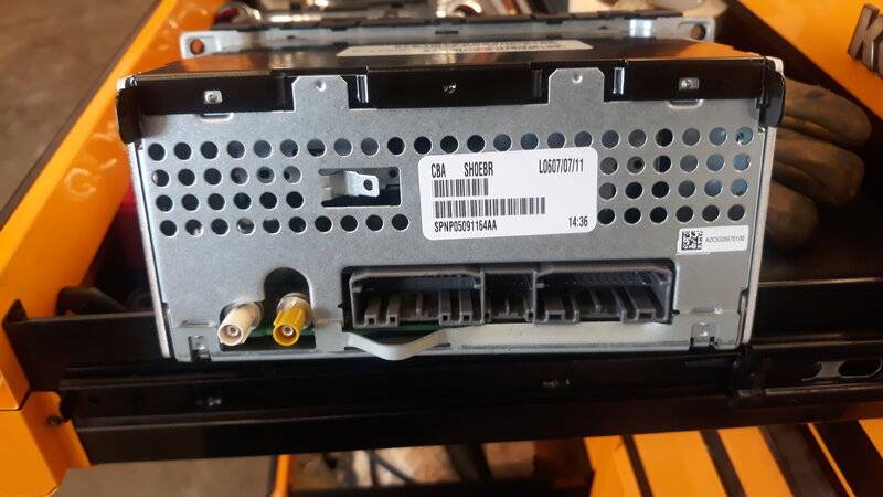

Pictures of the radio I have are shown . It has multiple connections on the backside,,,but my truck only has 1 wiring plug that I found that plugs into it
The display lights up, but I get no channel selection or sound of any kind
So put the aftermkt back in for now. But I would prefer the OEM radio if I can make it work

I don't think with that radio it does, that radio was used in a number of vehicles and the other vehicles could use the other plugs. It does sound like the radio is in theft mode and the code will need to be entered. the code can be had but a vin and the serial number of the radio is needed.
Thanks. Im off friday so will contact my local dealer and get this code and get an antenna lead ordered
