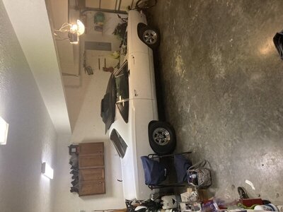

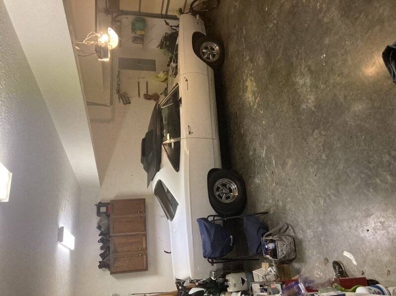

I just bought a set of 315 60r 15 . They are for sure to big with out chassis mods .
Trying to get the biggest tire I can on this superbee. Mostly for the look. I can live with Minor rubbing on hard turns. I am thinking if I go down to the 325 50 I might make it happen.????

I couldn't believe it initially, but there's a guy in my area, has a 68/69 road runner with 315/60R15 on the rear... with the correct backspacing of the wheel, it is possible ! He didn't know what his was, it was just a steel wheel.
It must've tire manufacturer difference.
Cause that 315 60 R 15 in my first pic would be rubbing for sure with our air shocks or moving the springs in with off set hangers and welding perches I think.

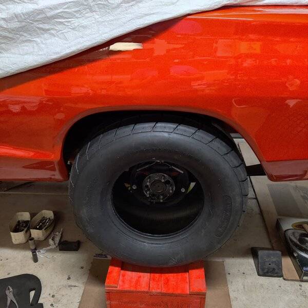

I’m not sure what the dimensions on 315 or 325 are but I have 29x12.50 x15 on 4.5” bs wheels. No rubbing unless I air down. When aired down they slightly rub the spring clamps. If I was buying tires again it would be 28x10.50.

Micky Makes a 295 55R 15 and summit says
28 tall
11.9 section width and 10.59 tread .
seams more doable than the 325 50 with 12.3 section and 10.3 tread .
