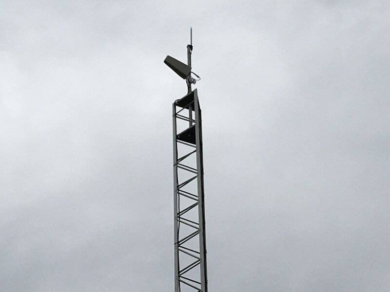

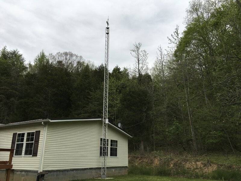

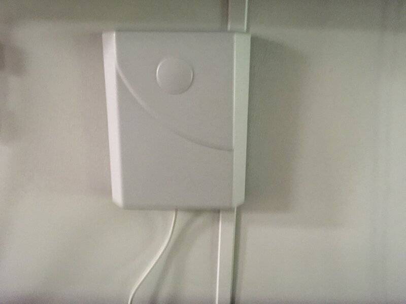

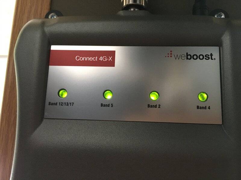

Here’s the one I installed and considering the holler I’m in it does well.
It does have a Wilson Omni directional antenna. Also included a pic of the inside and outside antennas as well

Nice set up. Yours is now discontinued and the show a replacement. Ouch over 1,100.00 bucks. I have a 30 foot tower that I might set up out there.
Yes they are not cheap but they work great. You gotta have some type of signal though in order for it to boost it.
