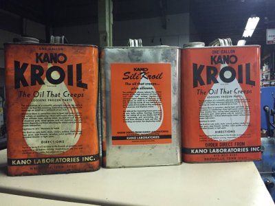

Can't say enough good things about kroil. I like to pre-soak any threaded areas that need loosening. The difference between kroil and other products is noticible. Kano makes many different products, all of them work well. I like the kroil with silicone. Here is some of my stash:
View attachment 331773 View attachment 331774
