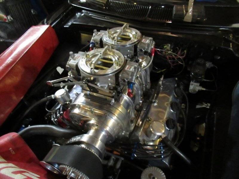

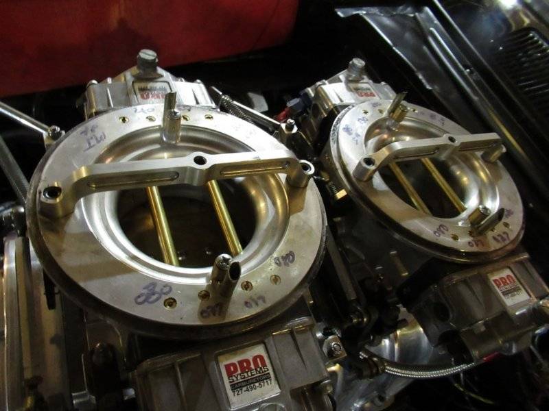

I put together a cheater plate system and after reinstalling the carbs I always check for WOT
but the blade from the SV1 carbs https://www.prosystemsracing.com/svseries/

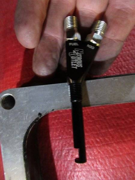

the blade hits the crossbar at 1/3 throttle so that idea in shot down.I ordered a pair of extended fogger nozzles that will be installed in the 1 inch spacer plate under the carbs.I intend to shoot 50/60 HP under each carb.The nozzles are capable of 175 HP each:rolleyes::usflag:. The nitrous will lower my IAT by over 100*:bananadance::bananadance:

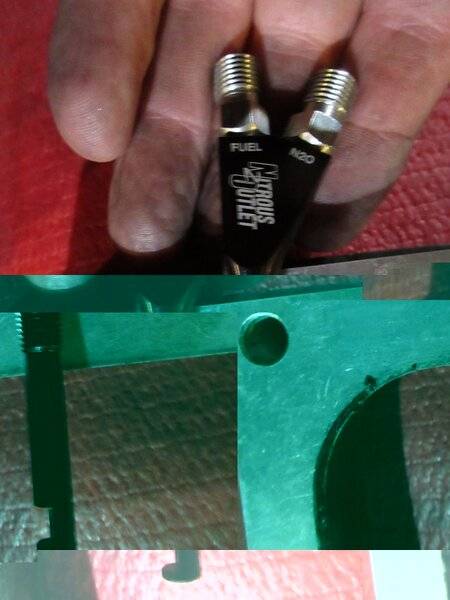

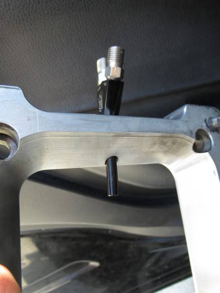

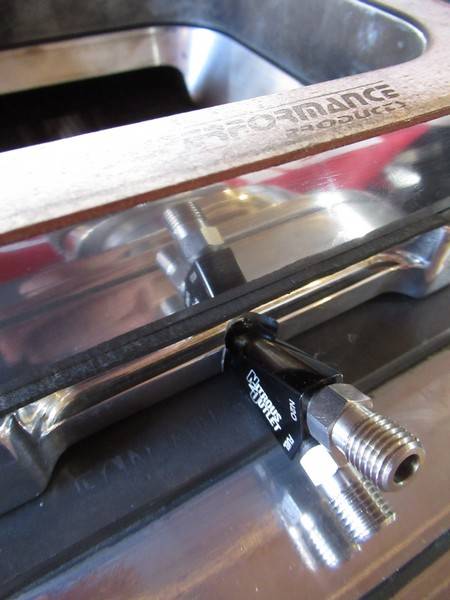

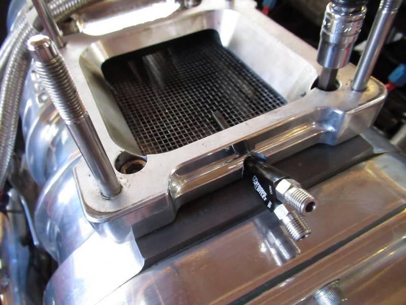

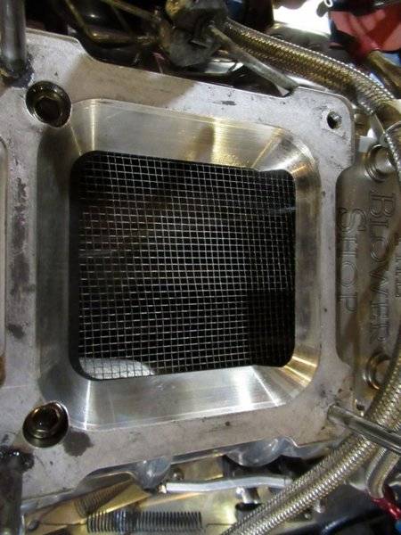

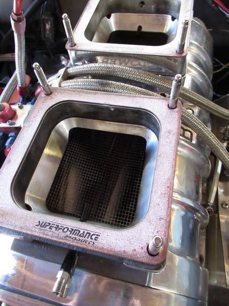

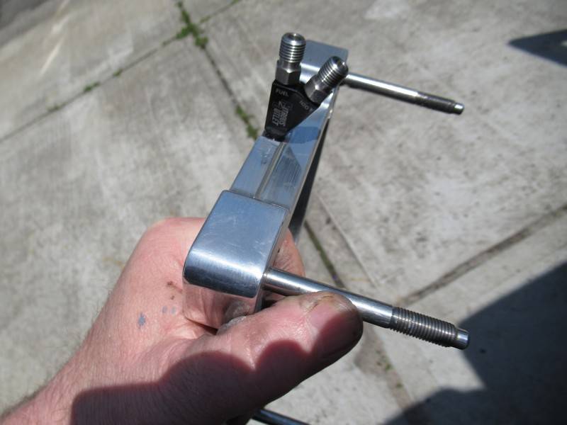

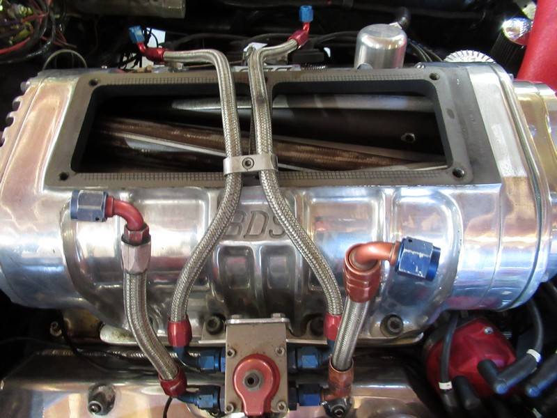

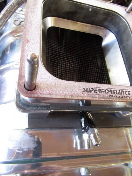

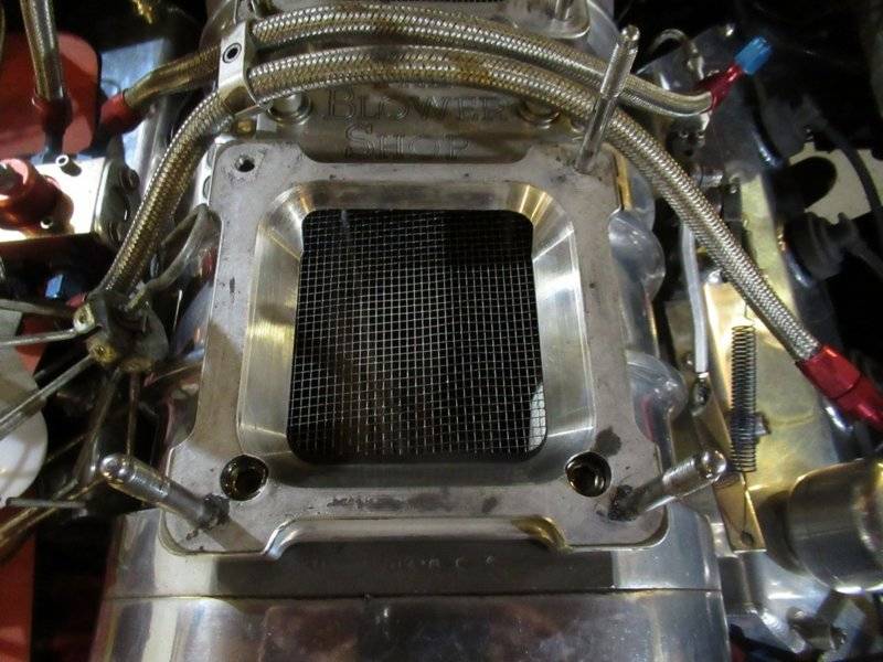

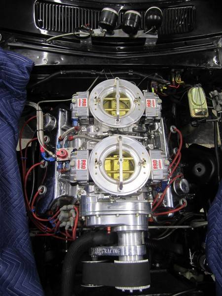

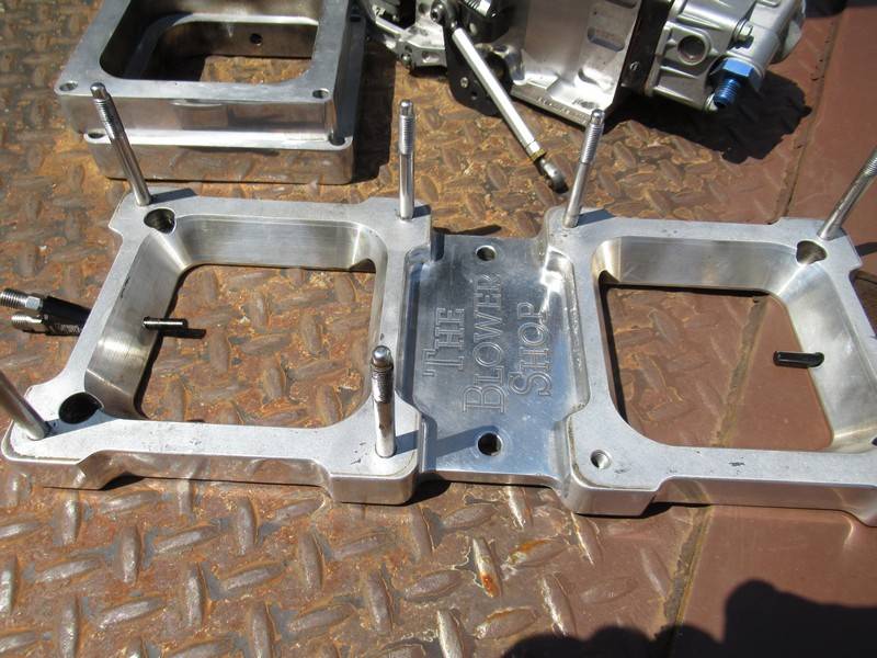

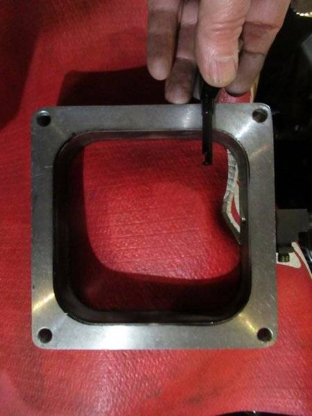

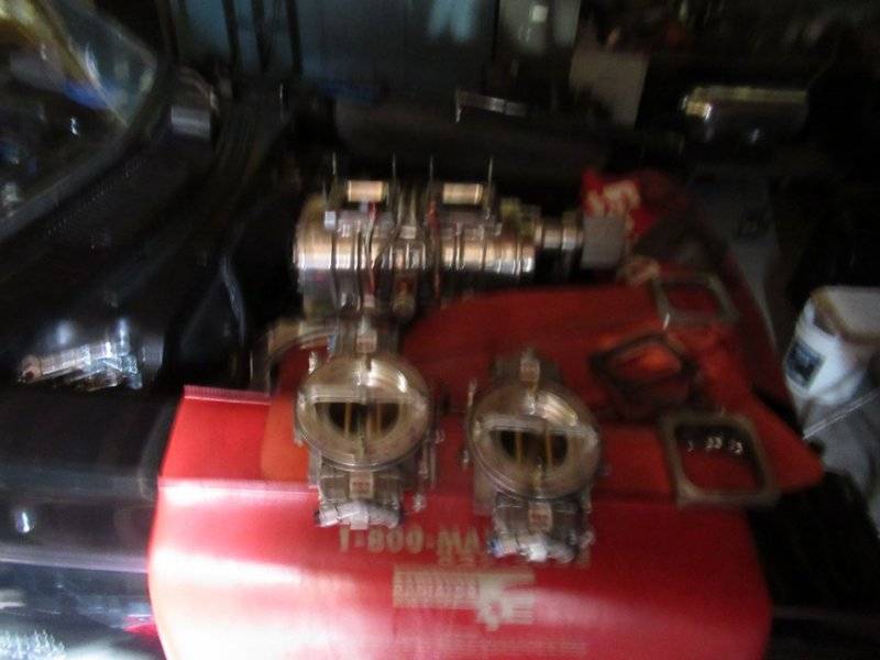

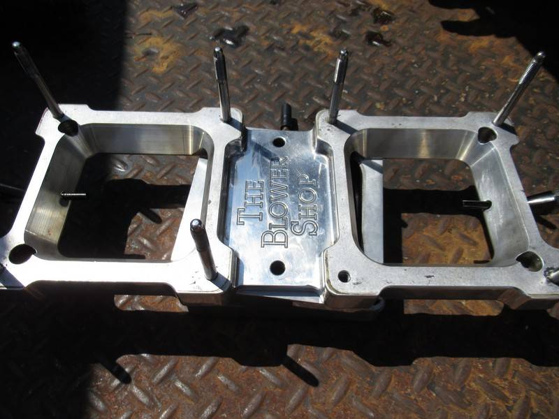

Took the carbs off to analyze where to install the nozzles.Looks the carb adapter install will keep the nozzles out of the way of the throttle blade:thumbsup:

The IAT will drop over 100* spraying 50/60 HP front & back right into the rotors. I expect to be about 50-80 * in the intake:bananaweed::thumbsup:
Juice come outta the bottle @ -129*!!!

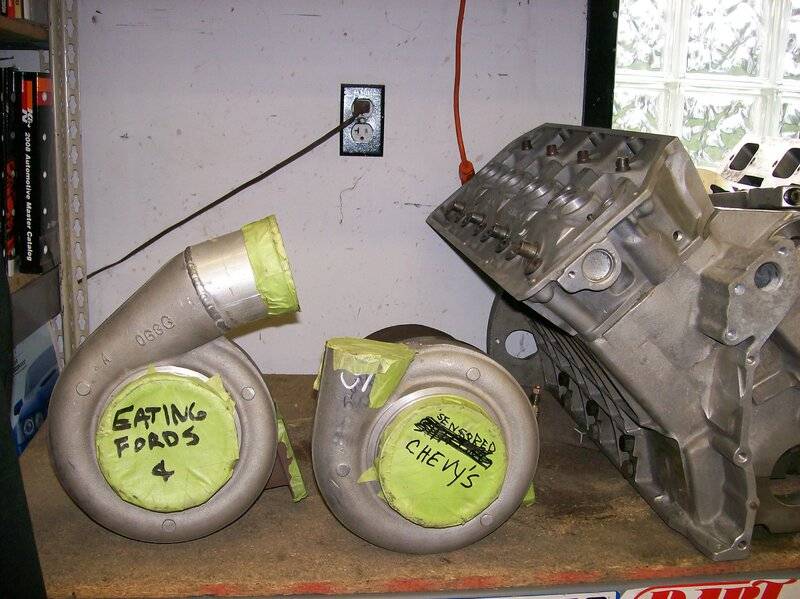

I have always been a blower guy. I love the looks and the sound. Nothing better the looks of a blown tubbed out any thing kind of car. Boost is good, but I have decided on big ole twins for boost on my next Hemi build.

How will you intercool the twins?

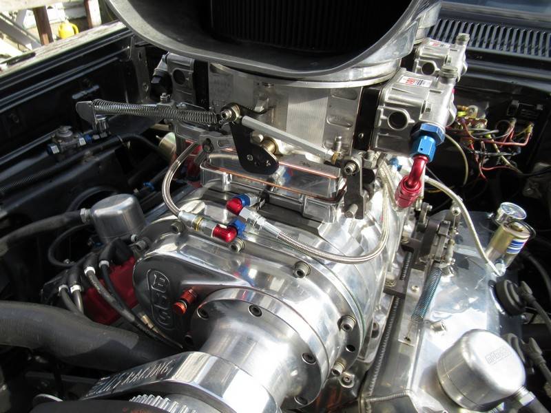

Monday I will make my final trip for a few 90* fittings and the engine is good to go.Then snake the long line to the trunk and bolt the bottle holder down.

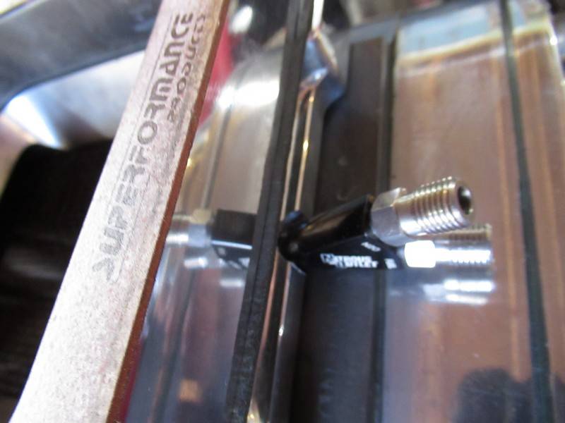

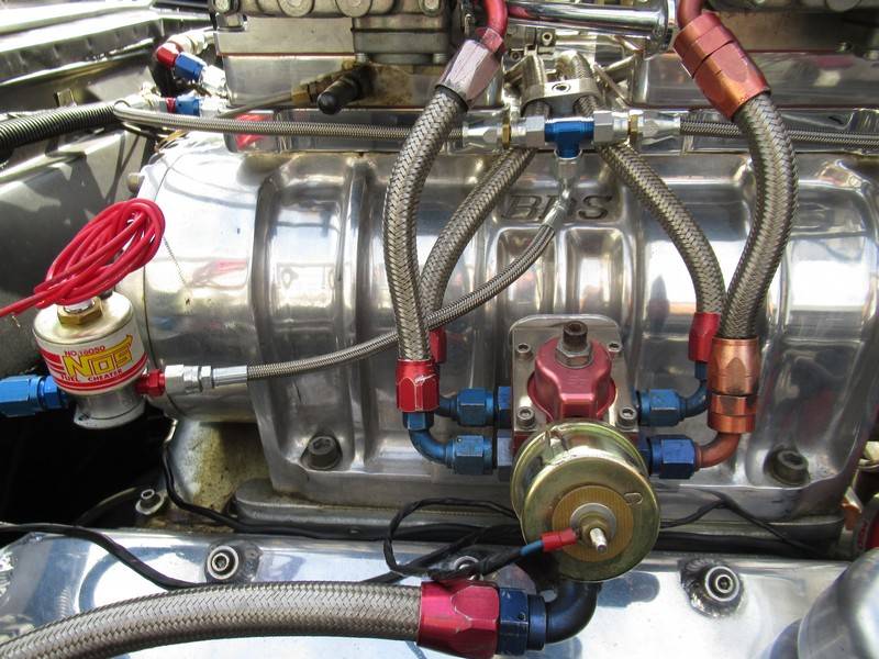

Update,,,,,the solonoids are in place with plumbing from the nozzles to the noids.Have to get up on a lift to run the nitrous line to the trunk and cut the fuel line in the wheelwell for a "Y" yo feed the fuel noid.
I ended up installing the nozzles in the front & rear into the carb adapter UNDER the carb spacer plate.I expect to slip into the 8's with the same 6 lbs of boost that went 9.36.
