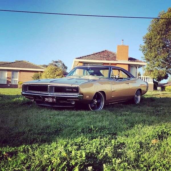

U.S. Mags Ramblers, 17x7 with 245/45/17s and 18x9.5 with 285/40/18s. Now just waiting for my Wilwood brakes.

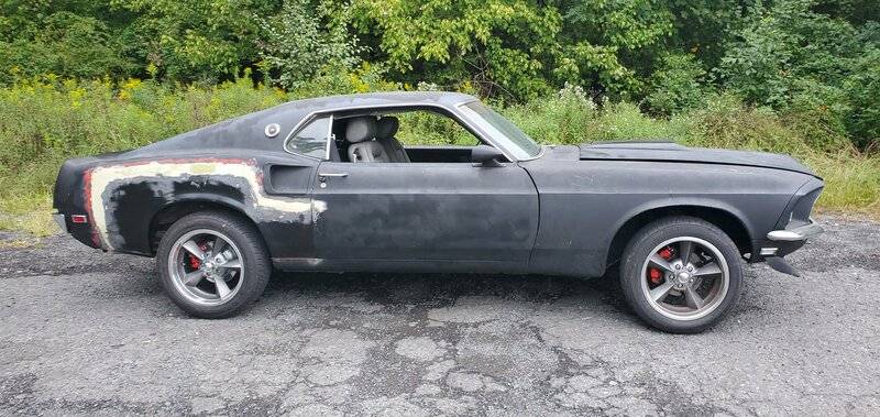

I sold my RR with these 18's. It actually worked ok with a base model pearl RR. The original dealer rims were stolen 2 days before I bought. The rims were $1k. Seller didn't change the price. But was not happy with his situation. But kudos for doing what he could.

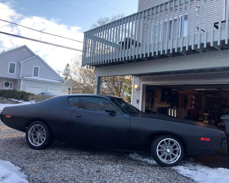

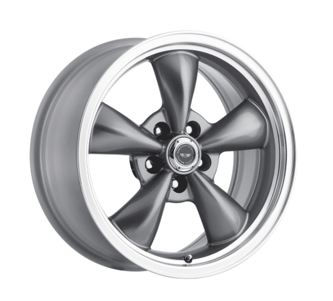

Anybody out there running 17-18 inch AR105 Torq Thrust M?
Ive seen pics of several guys running late model mustang rims (the "m" in ttm), but mostly on a-bodys. The extra backspace of the m's work there because the late model disc brakes and b-body 8 3/4 swaps add track width, the m's backspace moves the tire back in under the car.
I think m's on a b-body would need spacers. Standard tt2s fit better, and look better, in my opinion.

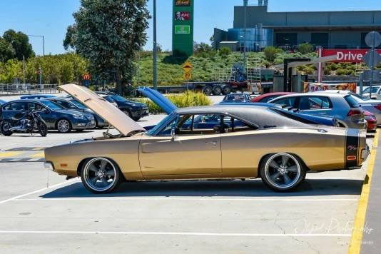

This was my car before I painted it. 18x9 front 19x12 rear. 345/30 and 265/40 tires. RMS front and rear suspension. Handled awesome but the roads around here suck. Car would bottom the rear shocks on the odd sharp bump. If I had of kept the car I was going to change the rear springs. The rear tires didn’t have quite enough sidewall imo. My current build has a rear tire with more sidewall and triple adjustable shocks.
