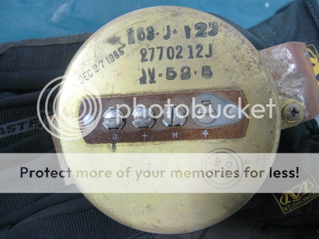

could be the sending unit under the glove box that's bad....or the gray wire is not connected to the coil under the hood.....

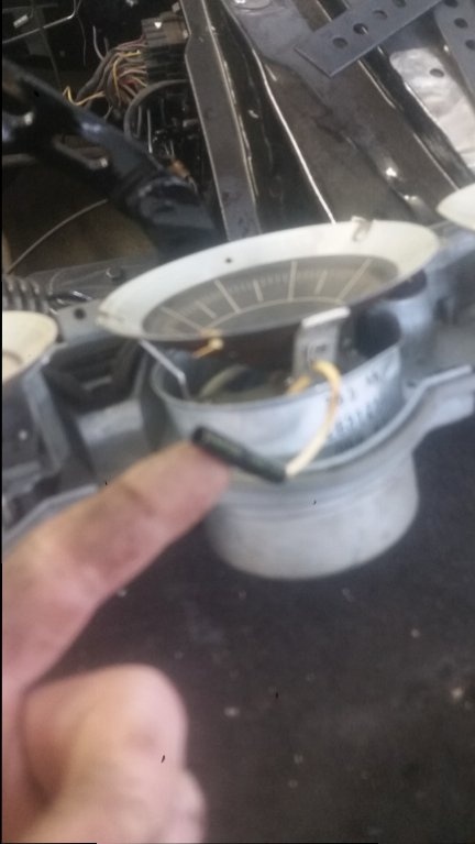

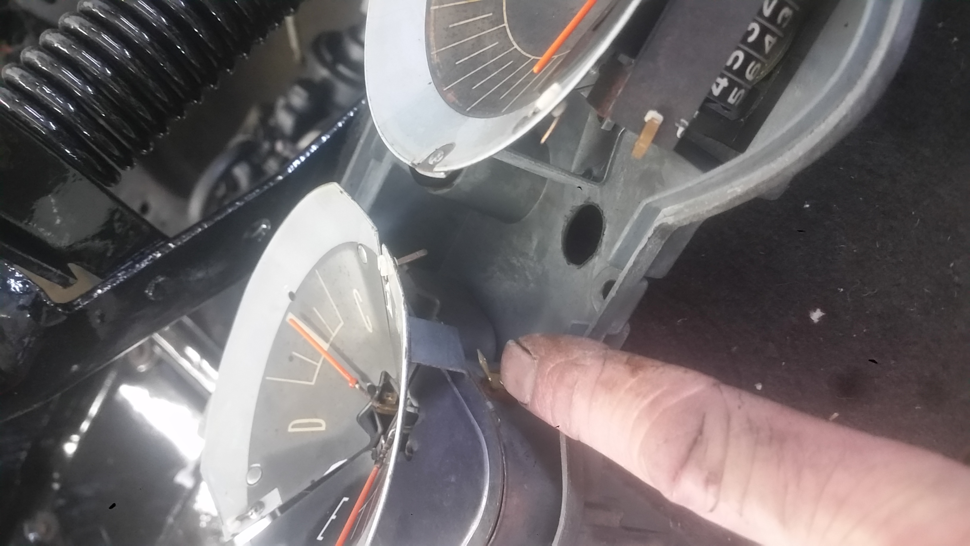

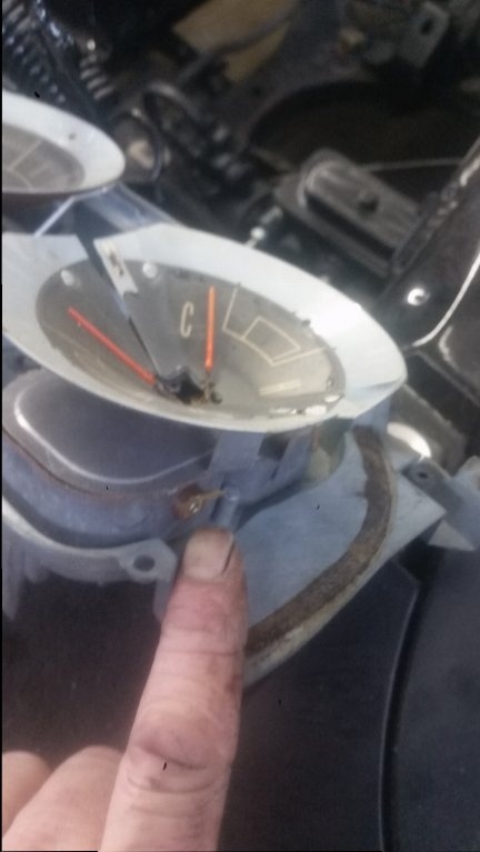

I Haven't got that far yet but apparently there is another sending unit missing behind the glove box.

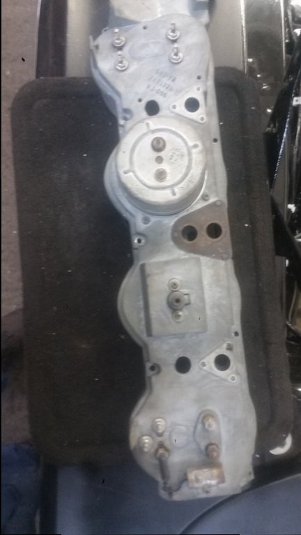

I can probably come up with the EL wiring that is missing inside the cluster, but not until winter is over...all my spare clusters & dash parts are out in the shed
