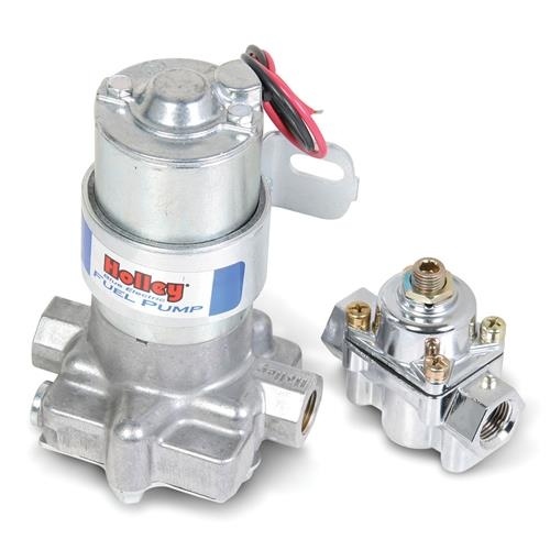

I'm sure you have one of these laying around...
