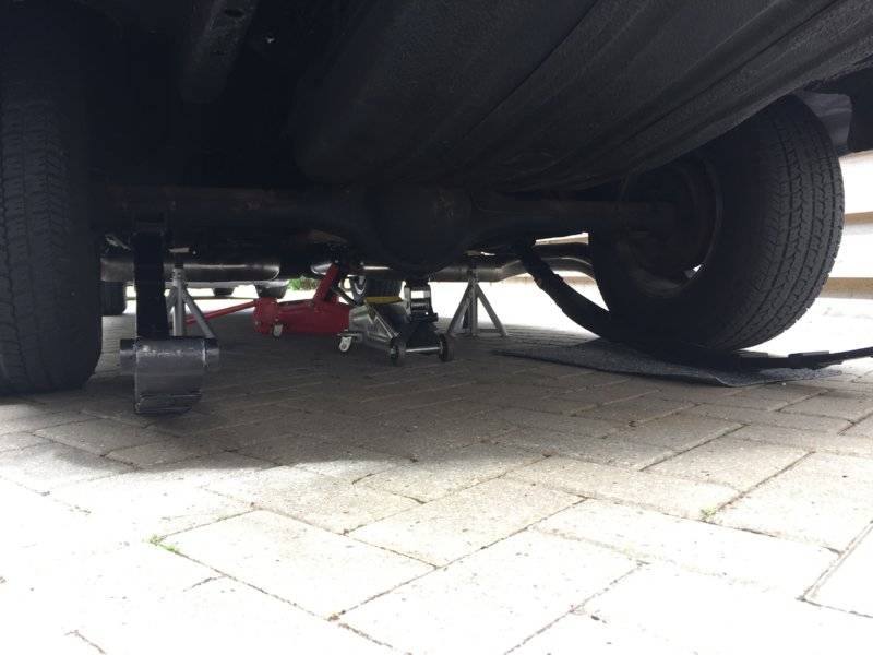

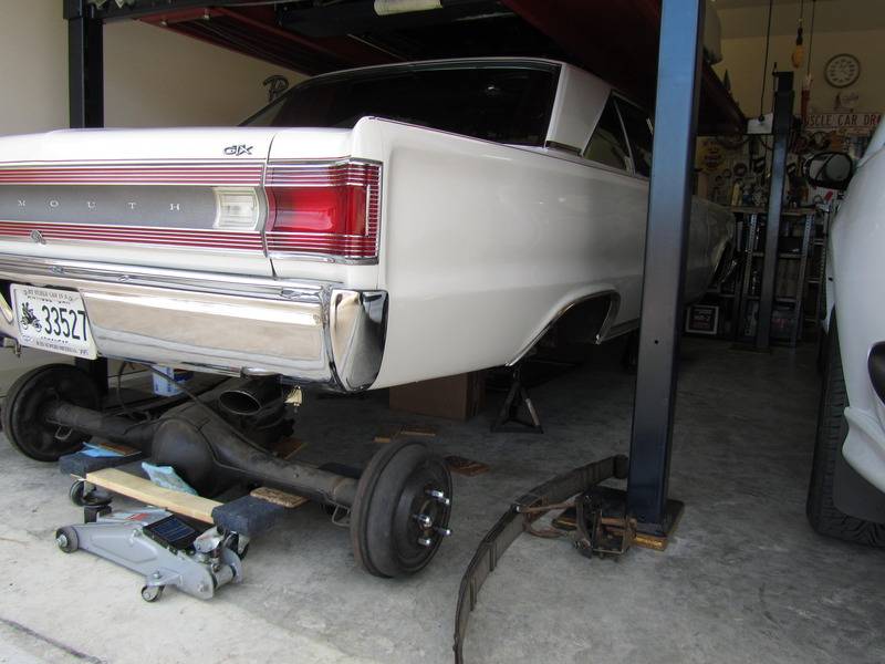

I have no lift, got 2 hydraulic jacks and 2 jack stands to work with.

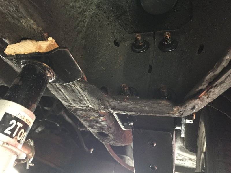

My thought was to raise the car, install the 2 jack stands on a location under the frame ??
Then i can use the hydr jacks to support the axle during shackle removal.

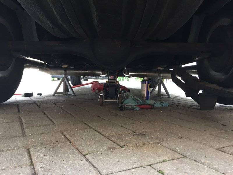

Put the jack at the pumpkin, and jack the car up. Put your jackstand at the frame rail near the front spring perch. Lower the jack till you just start to take pressure off the springs. If anything is in a bind when you disassemble it, you have too much pressure on the springs, either by the jack, or the weight of rear end
Thx JB, wasn't sure to support the car under the frame itself is the best position.
Guess once the wheels are about to come free from the floor that is the point where the spring will be sitting in it's tension free position and is safe to loosen the shackles.

Where you position the stands varies by the car and better to have them behind the axle and not in the way of the shackle bolts if you have a good frame location. In one case I dropped the exhaust pipe rear hangers so they were able to be slanted out of the way for me to have a trusty location for the stands. You should have a support under the pumpkin removing the springs; but not enough to have tension on the springs. This could be handy when trying to align the bolts when installing new springs. You're not thinking of blasting with axle housing on the car right? I took my axle housing off when blasting and powder coating it and having done blasting under a car...it's a messy bitch as posted above and you may blast some areas you don't want blasted including fuel/brake lines. Maybe I miss-understood...if not might think on combining these chores when you're ready to remove the axle housing. Can you find a buddy or relative who can loan you a floor jack?

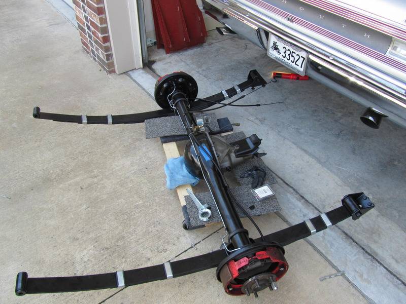

We put our jack stands under the frame right in front of front spring hanger. Used a floor jack under the pumpkin. We had the wheels off as we were completely removing the rear diff. Replaced everything and rolled the diff back in place and bolted everything back together. We left all the bolts a little loose that go through the bushings until we jacked up the rear diff to get the stands out and put them under the differential to squat the suspension. Then we tightened the bolts to reduce suspension bind. That's the process we used. Seemed to work out good.

I would probably do the rear end at the same time as the suspension. It's easier to just pull all the components at once.
I carefully masked my differential housing to keep sand out of it - think I used Gorilla tape over the top to stand up to the sandblasting.
Sandblasting the springs is a real chore at home with a small blaster but given enough time - it gets done. I was real careful to keep the leaves for each side together and oriented front/rear together so I didn't mix anything up.
And it looks 100% better when doing the whole unit at once when it goes back in.

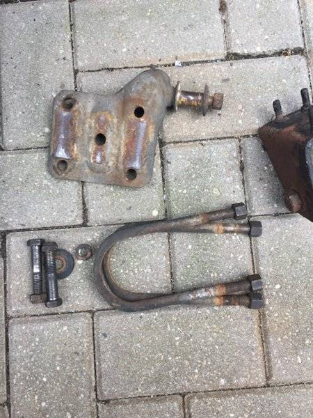

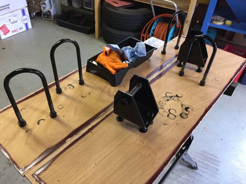

Edit: i got new leafs springs which are already prepped in a coat of POR15, just need to clean, blast and paint the brackets and bolt it back in place with new bushings etc.

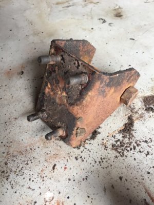

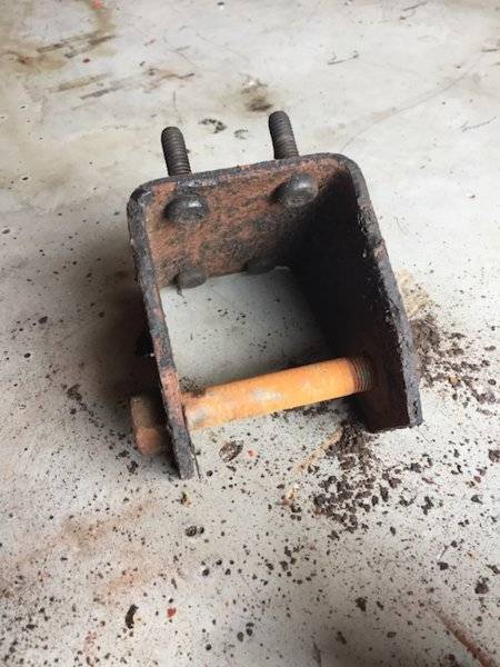

I believed the bracket at the axle itself also should come off?
Looks like its welded onto the axle tubes....
For some reason i am not able to upload any pictures...says file size is too big but picture size is below 200Kb...
The bracket on the axle does not come off. It keeps the axle centered left to right and front to back on the leaf springs

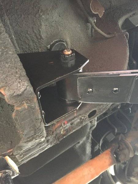

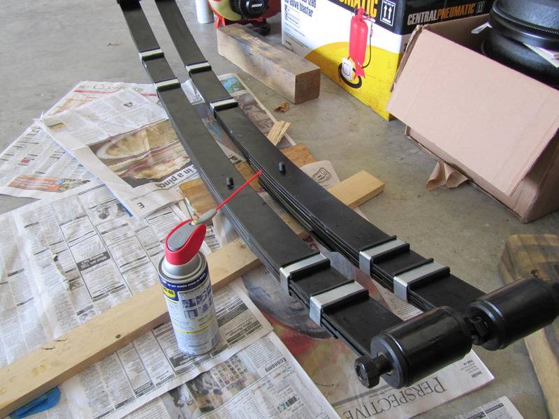

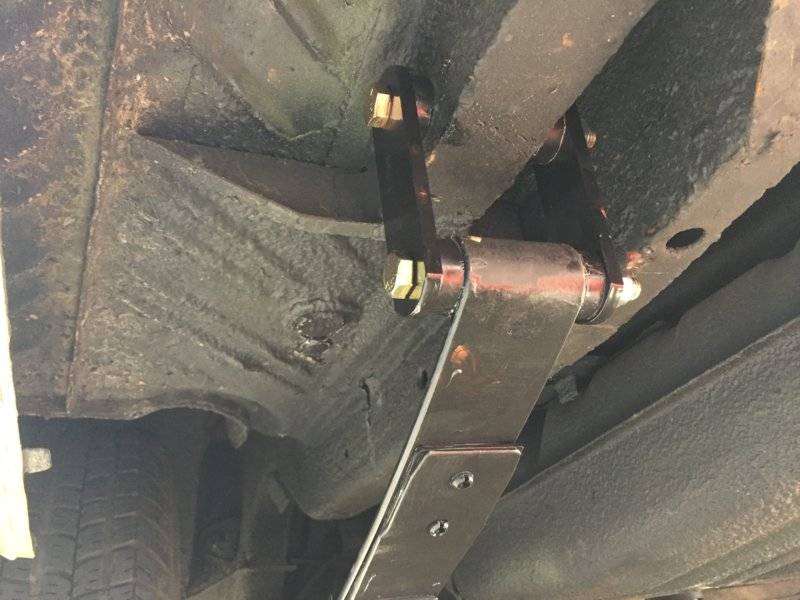

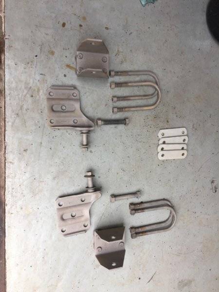

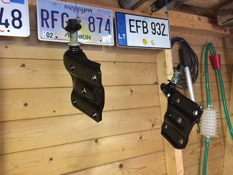

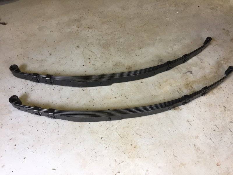

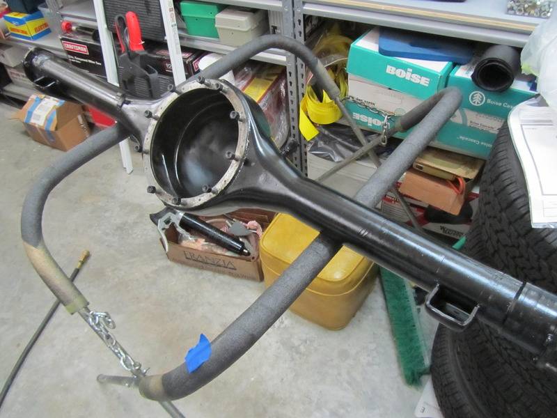

Some progress, all items that are going to be reused were blasted and painted with POR15! :)
New XHD leaf springs!!

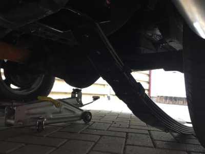

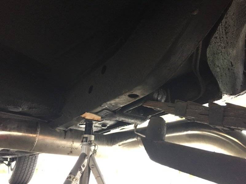

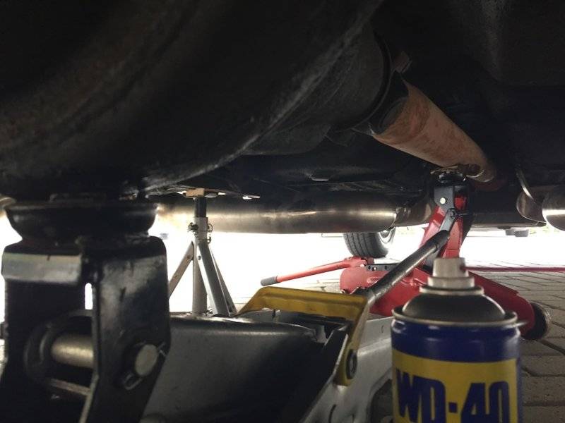

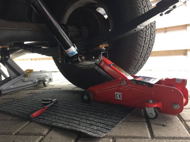

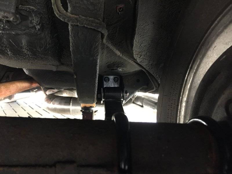

Also added some pictures of how i set up the jacks to support the car, and to support the axle and shaft.
Once it set on the jack stands, the wheels were off the floor around 1/2" and they dropped down once the spring is loosened.
Think i might be able to lift it by hand the get the last shackle pin in.
IMG_9773.jpg IMG_9775.jpg IMG_9776.jpg IMG_9777.jpg IMG_9764.jpg IMG_9765.jpg IMG_9767.jpg

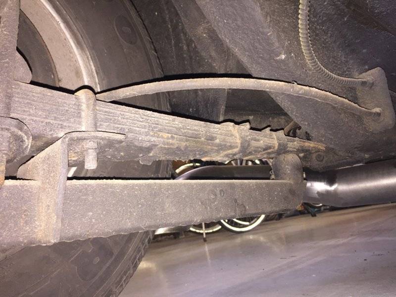

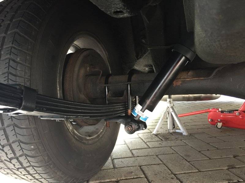

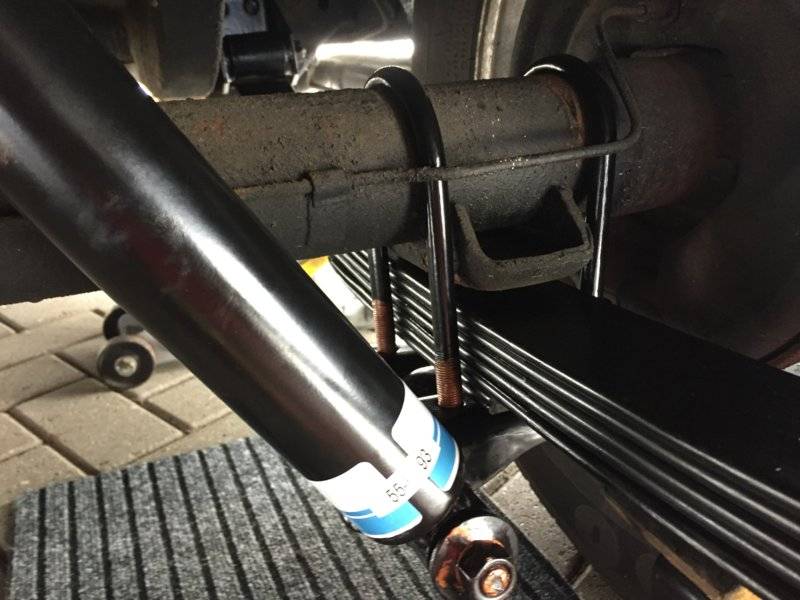

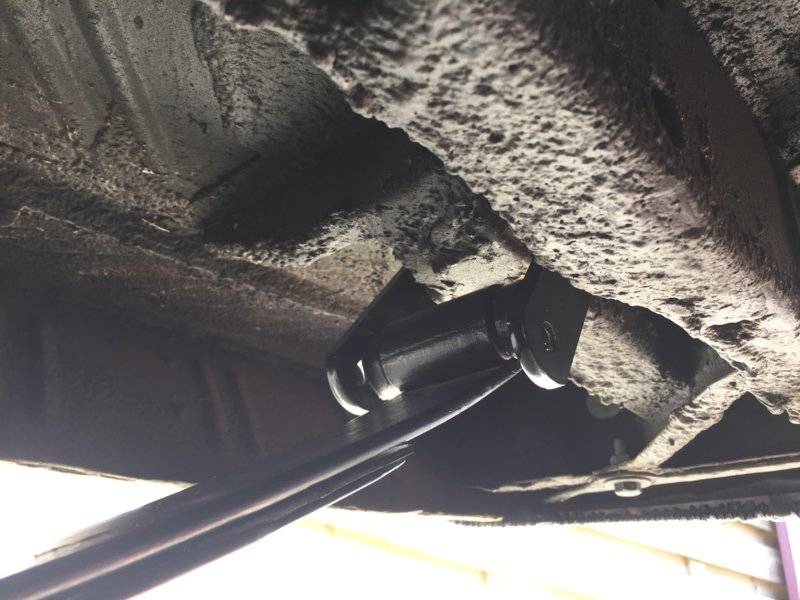

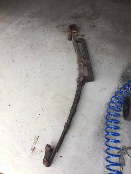

Mission completed!
Only had to jack the car up higher when installing the new leaf springs, probably shows how far the old leaf springs were shot.
For the rest all went smooth, thx guys for your suggestions!
Trunk lid height is just over 38" now, stance appears similar as before, although the old springs were supported by the additional bars. (don't remember the name)
IMG_9779.jpg IMG_9780.jpg IMG_9781.jpg IMG_9782.jpg IMG_9783.jpg IMG_9785.jpg IMG_9786.jpg IMG_9787.jpg IMG_9788.jpg IMG_9789.jpg
