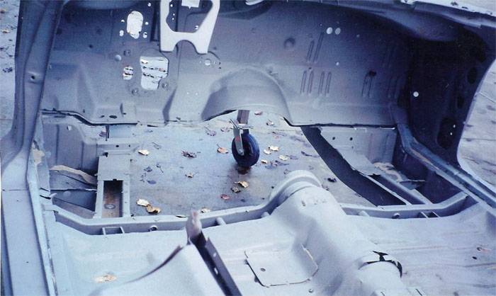

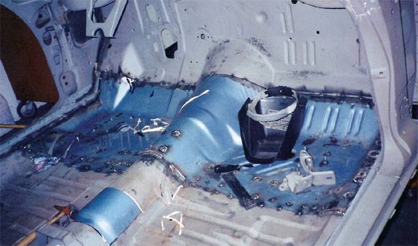

I did do a partial floor on my Coronet..

The hard part, which I didn't do in this case, is drilling out the donor panel - and not drilling completely through both panels.
I was mindful of this in other sections that I drilled out. You want the panel with the hole to be on top of the panel with no holes.
Mark did it perfectly.
Holes where you need them, no holes where you don't, so no need to fill unwanted holes. For example, drilled through where it sits on the frame rails, no holes where it sits under the trunk pan.
I used a spotweld cutter where it didn't matter, and one of those bits with the round grinding head where I didn't want to a hole through the bottom panel.
A larger drill bit also works as long as you're careful and don't force it through the bottom panel.

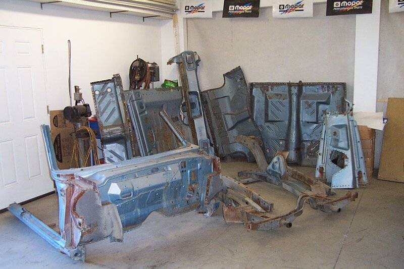

In my Hay Day I could drill out the 5000 welds and completely disassemble a unibody in about 40 hours. No cutting.
It was easier when we were younger, stronger, more flexible, more motivated, dumber.... LOL...
