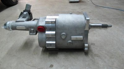

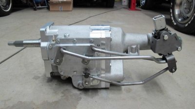

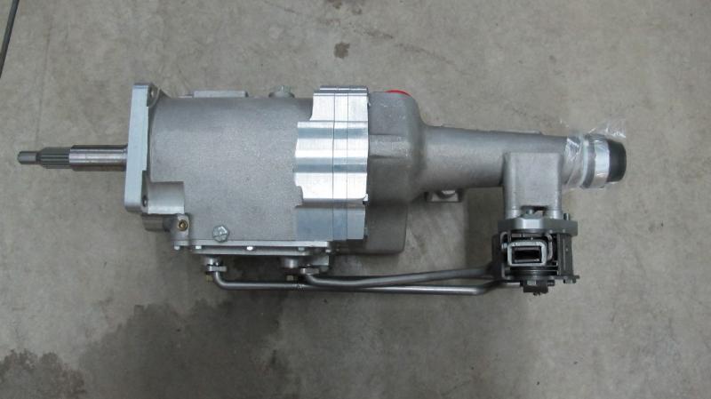

Picked up my Passon 5 speed OD tranny this last week.:blob1::blob1:
I was #4 on the production list, but Jamie said he has almost 400 people wanting one!!!

Maybe in a few years. Lol
Looks nice. Love your build thread over on FABO.
NICE im after that tranny . good to see hes got them now .

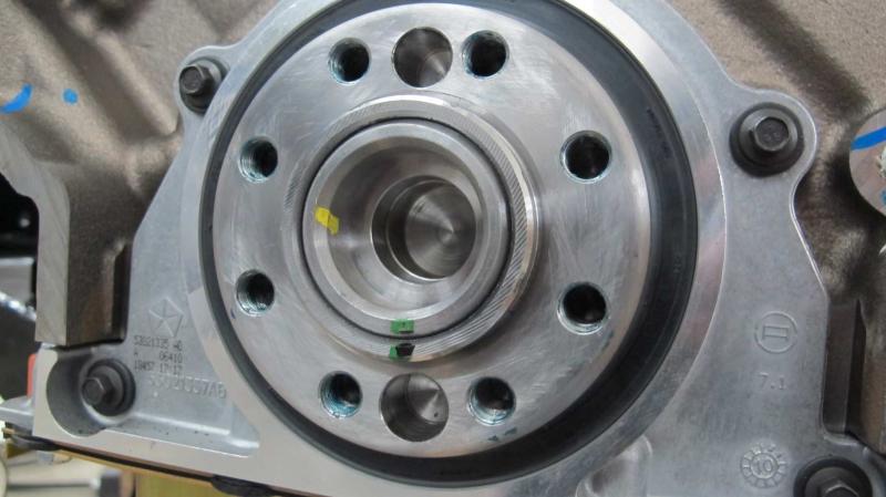

I know the crank sticks out a little bit further on the 5.7 so that is probably the biggest obstacle if you use a factory small block bell. Not sure if the aftermarket bells compensate for that. And not sure about the pilot in the crank. Im gonna check my engine tonight and see what the end of the crank looks like.

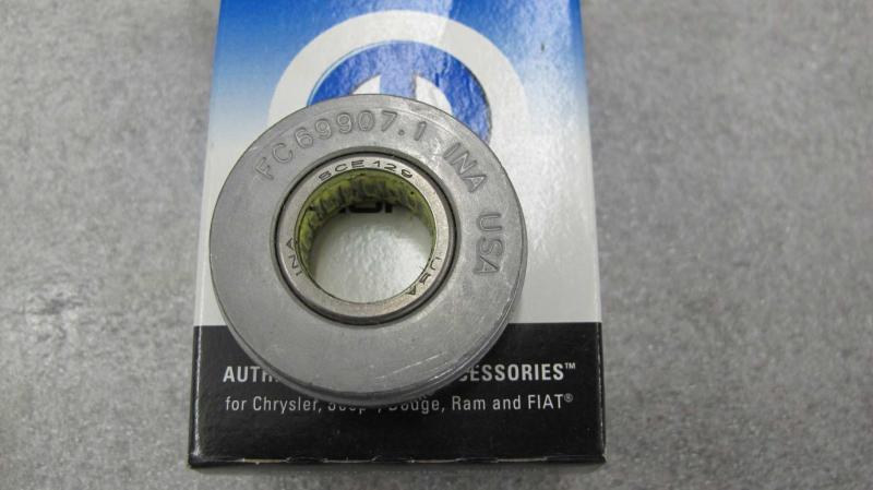

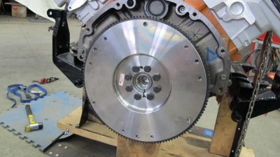

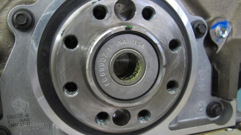

Crank flange
yes, the crank flange is further rearward than a stock SB Mopar. Plus a special flywheel is used - eg McLeod 464108. You will have to cut ~7/8" off the nose of the input shaft on the tranny.

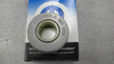

The crank usually has an adapter ring installed that you have to remove and then install a pilot bearing like 53009180AB.
View attachment 160347View attachment 160348View attachment 160349View attachment 160350
So does the flywheel make up for the crank sticking out or does the bellhousing have to be spaced back?
Yes. The flywheel makes up the difference in offset. No bell housing spacer needed.
