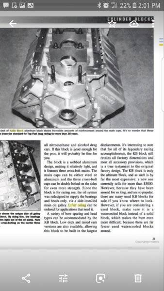

Thought you may find this interesting, looks like something was available to fit it with lifter oiling capabilities according to my book?
What you've posted is relevant for newer blocks, it can't be added to my casting the same way. I would have to build custom feed lines.
It shouldn't be too hard to add a spray bar over the cam and feed it through the rear bulkhead.
