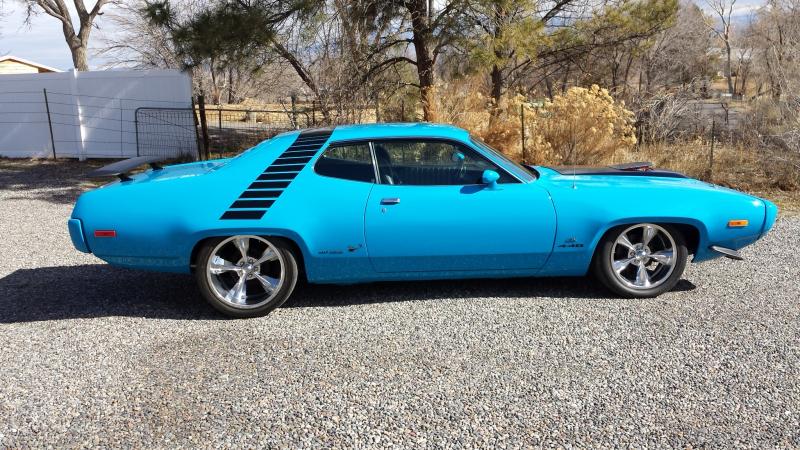

I put MF 2" drops with 1" bars on this 72. We're pretty happy with it. Wheel is a 18x7 w/ 4.5" bs. Used the factory disc and the backing plate won't fit back on. Their spindle nut and washer were a joke so reused the originals. The ride is nice with the 1" bars.

Your car looks awesome! great stance and wheels!

Did you also lower your torsion bars along with the 2" drops?

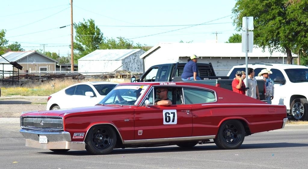

2" Magnum Force, 1.14" torsion bars, 1 3/8 Hotchkiss sway bar. Good and stable at 150# mph.
235/45R17 on the front, 255/45ZR17 on the rear, both on 17x8 4.5" BS Cragar Soft 8's
What is the ride like 67Charger? I have the 1.14" bars on my 73 currently and they are firm but not harsh in daily driving and am going to install the MF 2" drop spindles this summer. I already have the spindles, but I keep hearing there are clearance issues and the ride will be harsh. I have almost exactly the same tire sizes as you with 1 1/4" and 1" sway bars.
Firm, and you feel the little stuff at lower speeds, but not bad. I'd run them again. No clearance issues anywhere.
