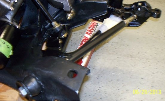

I just assembled my adjustable strut rods from PDT. I'm putting my K member together wjile the body is being painted. They went in with realatively no problems and I like them. Ran out of time but plan on putting the anti-sway bar and assemble the brakes on the K. So far so good as far as the PST strut rods are concerned

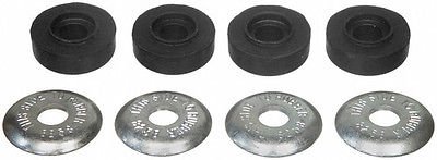

Half considering keeping my strut rods and going to the 2pc Moog K7039 or K7040 whichever proves to be the correct ID for my strut rods.

Measured my '62 wagons strut rods last night, .72 dia. So the Moog K7039's with .714 ID are correct, and Firm Feel confirmed that. Will mount them with the convex side of the washers against the bushings, and with my original strut rods.
