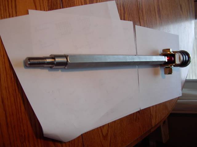

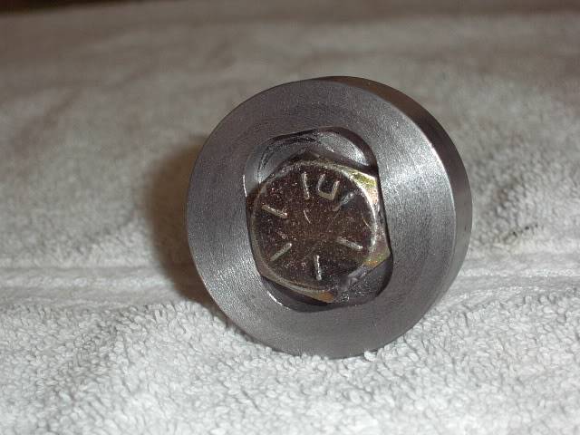

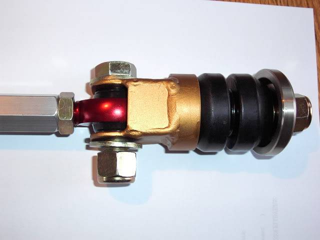

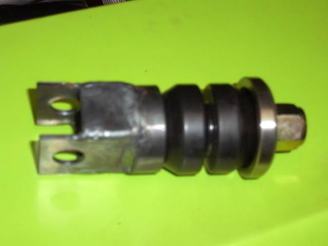

I made my own. I wanted them mounted in urethane to dampen road shock/noise? I agree they should not be used to get more caster but to adjust for the "sweet spot" where the LCA bushing doesn't bind.
