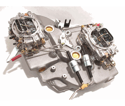

Looking for anybody that has had experience with the Mancini 440 Cross Ram Induction Package. Any pros or cons?
I have a '64 Polara 500 with a '63 413 bored .060 over with 440 906 heads and am thinking of getting this set up.
Can't tell, but looks like it may be the A&A intake.

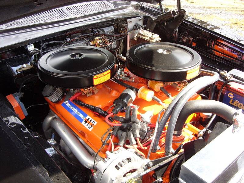

my dad used the kit with the 440 ports on a 413

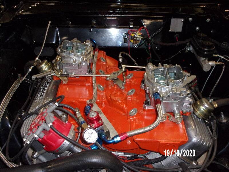

I ran a max wedge on the street. Its a decent choice. I never had a backfire. If you buy a new one, or any one really, buy 3 sets of intake gaskets. Install with gaskets dry. Remove manifold and check the impressions. For alignment and depth of impressions. Deep impression here and light over there can point out a problem. Odds are a new manifold will be too wide. Rides high on the head. If you need to cut the manifold go to the best shop you can. The manifold is difficult to set up properly to cut down. If you can watch them do it. If you can't check it very closely and test fit it again. 3 sets of intake gaskets!
I'm doing this now. What limits do you get with carb choices. I'd like to run this set up with no scoop and with air cleaners. Goes into an early B body that gets a 440 stock bore. My car is a manual and has power brakes so I'd like to keep some vacuum. What's making you go Cross Ram HemiLane? I want to here what Indy and A&A have to say tomorrow. Cam tech today should be able to tame a Max Wedge but by how much? I'll be watching your responses.
I decided against the Cross Ram. The manifold is not going to clear the aftermarket AC compressor and I don't feel like relocating it.
