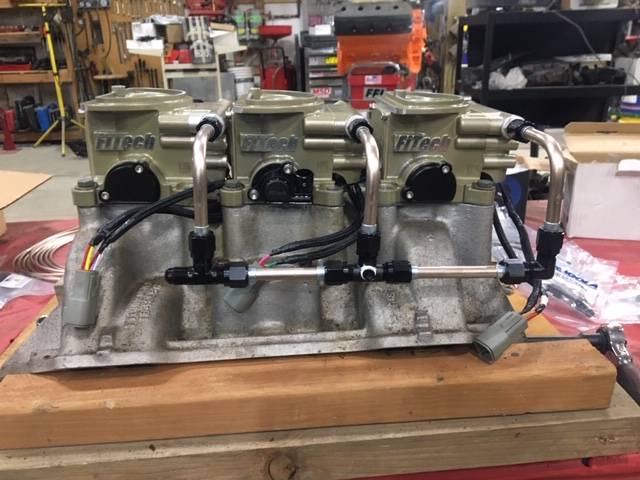

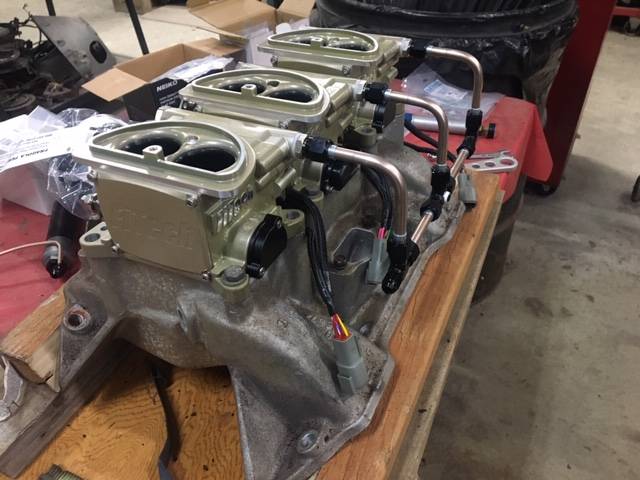

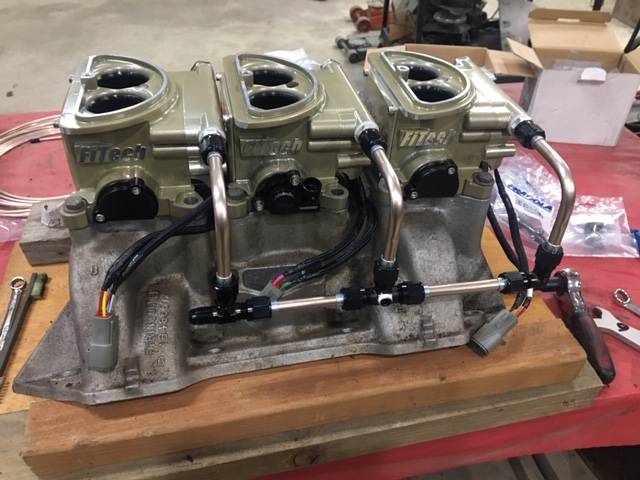

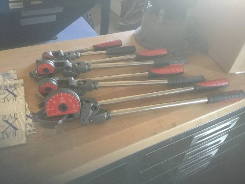

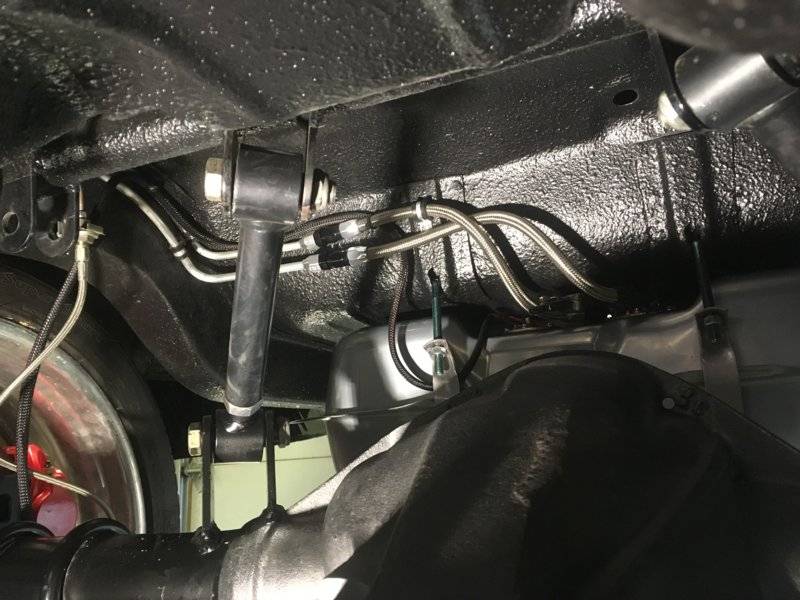

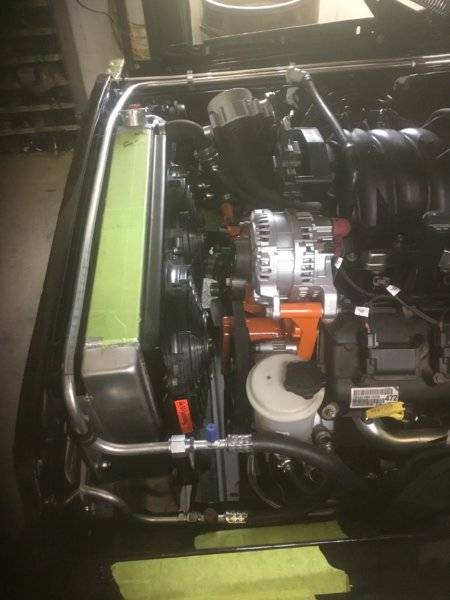

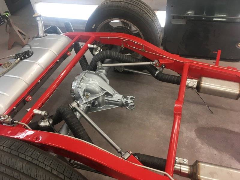

Thank you sir! I was able to bend some of the line I have by packing it with dry sand. That said, no way I can use this for the entire feed or return line because I would have to fill the entire line which might be 7" long. Here is what was able to get made though.
