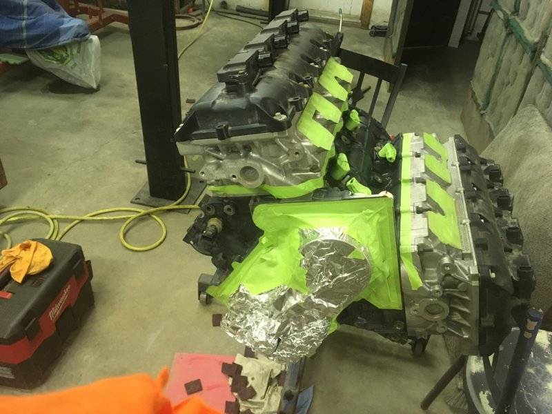

I tried a search and didn’t turn up much. Im starting to install a 6.4 out of a 2017 truck in my 69 Coronet. I have an RMS suspension, TTI headers and an old Keisler TKO transmission kit with a quick time bell and hydraulic t/o setup. Hotwire did the harness for me too. Just wondering who else has done a similar swap and can share some info on problems before I run into them myself.

Stock pan from the truck is rear sump and does clear with room to spare. Although I don’t know if I like the ground clearance. Once I get the tranny in i will know exactly what it is. Anyone else do a truck hemi with this front end? Wondering about a/c and power steering pressures.

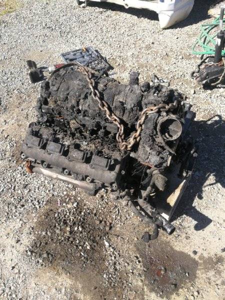

Thanks for the info, my intake points up on a truck motor also. So it looks like I'll be doing the same thing. I bought this 6.4 from a truck in a shop fire. I plan on changing the top end anyway, but was not sure how deep this rabbit hole is gonna be. But for 1,000 bucks and 40,000 miles on it, I'm up for it. Thanks

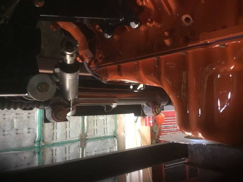

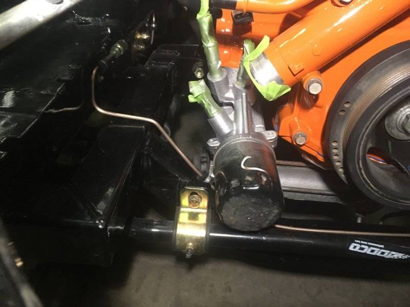

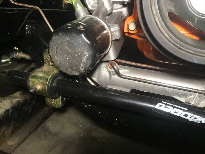

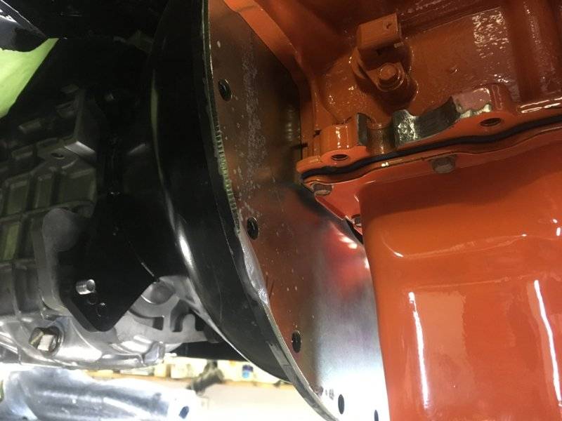

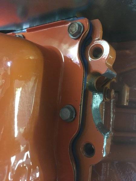

I should be getting my transmission mounted this week, then i can find out if my truck intake will work with the stock hood. The factory oil cooler is also very tight to one of the steering rack tubes. Power steering pump reservoir sits about where the battery tray needs to be. A/C pump clears with no problems. TTI headers appear to hit a boss on the block at the oil pan rail, should be able to grind that back. The hydroboost is challenging getting lines bent to clear clutch lines,header and steering shaft. Everything fits as usual with this stuff, almost but still needing a little cut/grind. Seems like I’m on my own with this particular swap combo. I will post pics as I get the issues figured out.

Got the motor and tranny bolted in today. All the front accessories clear. The oil cooler is the closest. It just clears the fitting on the steering rack. TTI headers clear on the passenger side with just a small bit of grinding on the block above the oil pan rail. I don’t know if the car blocks have that. Drivers side looks good too, but I don’t have the starter yet.
