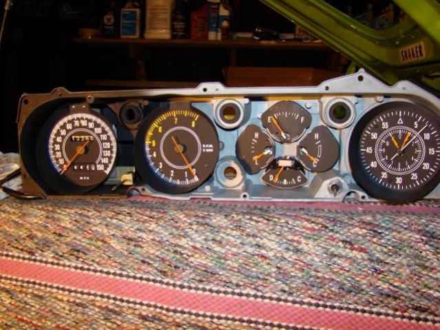

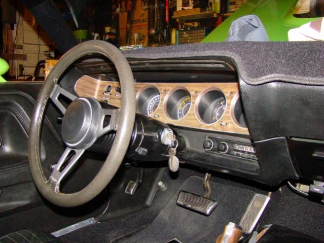

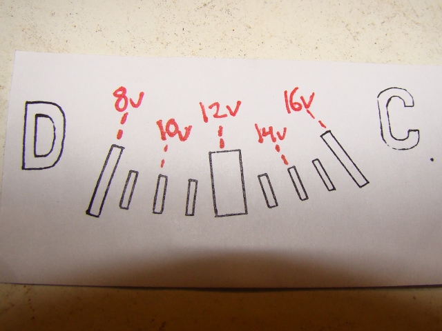

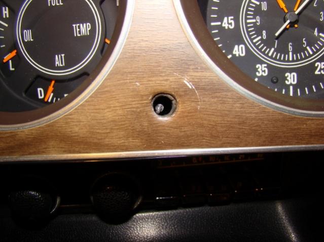

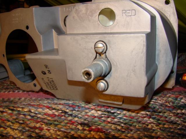

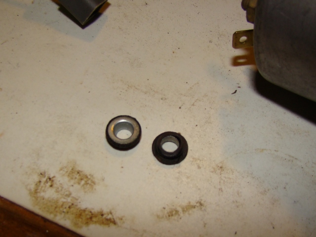

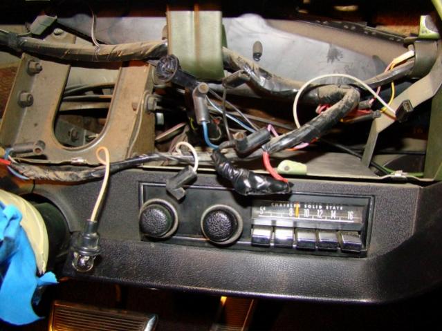

I had to reinstall my speedo / tach as they were restored a few years back. I only used the finest Canadian imported speedo grommets. These are a crucial step often overlooked! Do not be fooled by imitations. THANKS BRAD! +Things went pretty smoothly with the exception of the cable for the clock set. I neglected to test fit the cover on the cluster before the install. I had to make a special tool to hold it to the side to get the adjuster (Ferrell??) seated on it. I will loan this tool to any member in need. ::) No time to fire her up for a test yet, but I didn't have any screws left over! They also sent a little diagram of how to read the gauge. One afterthought.... tape your column up well so you don't mega scratch it like I did.

here's an update - I got lazy and just cut/paste from C-C
part1
Well I had her out this weekend. Met up w MOPAR FANATIC Saturday nite, And went down to the FOX LAKE show today. :thumbsup:
And of Corse there's a few things I need to address.... ever notice how one thing leads to the next... :eek7:
First off my fuel gauge finally reads all the way full. Haven't seen that till I pulled the 5/16 and went with the 3/8. Oil Press still reads 80 psi most of the time... once good and hot aybe down to 65 at idle. Is my OP that's good... really ? :clueless:
Secondly my volt gauge (amp converted) is erratic as all get out. Worst at idle, solid at highway speeds. I think I saw a post on that someplace.... :dunno:
Third........ THE NEW CLOCK DONT WORK. :swear: Granted, I did not check the hot lead for "hot" before reassembly.... but everything else in the cluster had power. There are no blown fuses/suspicious looking wiring/bad grounds that I am aware of. Lets pull the dash apart again.... yay! :faint:
the clock is $hit!... not happy... calling Shannon tomorrow..........
That sucks having to pull the clock out again, but from what I have heard they will make it right with you. I may have missed it in your posts, but did you do the MAD electrical conversion, or something else?

Here's todays episode -
I talked with Johnny today ( who ever that is???) as was told Shannon is on vacation. He told me they run the clocks 24HRS before they ship. He recomended that I try and advance the time to see if that does it. Then recomended I tap on it. I said... you really want me to tap on it? He says, well no not really. Any way I tried it again and played w the advance...... JACKZIPDIDDLY!!! FEDEX just picked it up an hour ago.. doubt she'll be out till after the 4th of July...
The needle on the crappolla meter is on the rise.. and BIGS being the patient, understanding guy that he is... DONT NEED THIS PITA! Stay tuned....
Now that Carlisle is over I got the cluster back in tonite. Clock worked as soon as I plugged 'er in. Tomorrow morning were heading down to the Belvidere show. Should be a good "test ride". Total time on this project.... granted Carlisle and all the HOT weather (it was a balmy 86 In the garage tonite, was over 90 last 2 nites) but it took about 6 weeks start to finish. Way too F'n long!
