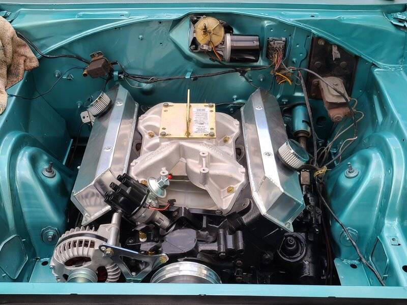

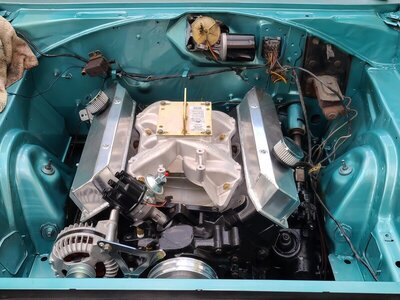

Wow! That is a stout cam for a 383. 12.5-1 compression? A little high for crappy gas/my purposes, but mine came out at 10.2-1 and I'm happy with that. Gonna see how it runs, hopefully this weekend. Still looks like this right now.

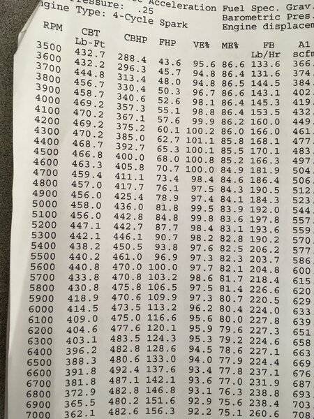

Three of the 383’s I tested all made pretty similar power....... like in the 480’s.
Two were hot street builds, one was a bracket race engine.
The two street builds got solid cams with duration @.050 in the 240’s on a 110lsa, the bracket build was 256 on a 106.
One street build got prepped RPM heads, the other got ported big valve 346’s.
The bracket build got unported 906’s with stock sized valves.
All were tested with 1-7/8 headers and RPM intakes.
The street motors were run on pump 93, the race motor got a pump gas/race gas mix.
All made mid-480’s for HP.
Until I did a little “cheating” with the bracket build.
On that one I had done some testing with an electric water pump, oxygenated fuel, and a carb spacer.
With those items in place, the power got bumped up to 504hp.
In that configuration it was also running the largest carb.
The others would likely have made similar power if tested with the same items.
