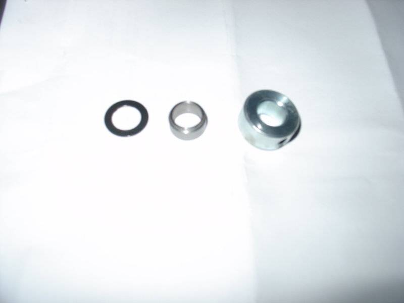

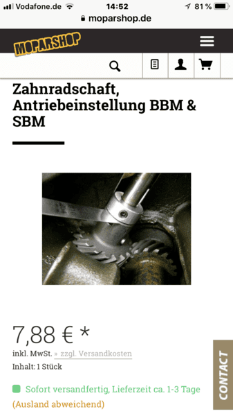

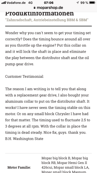

Hi guys,
Has any one install this collar on the distributor shaft ?

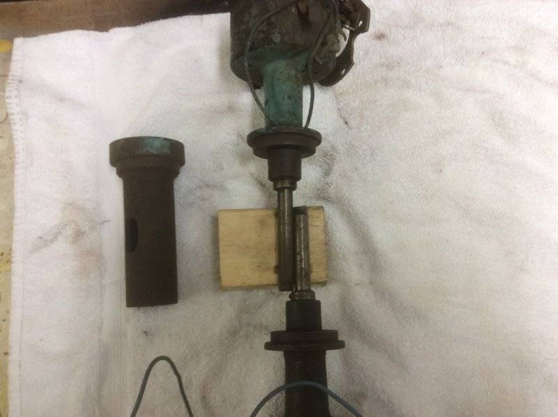

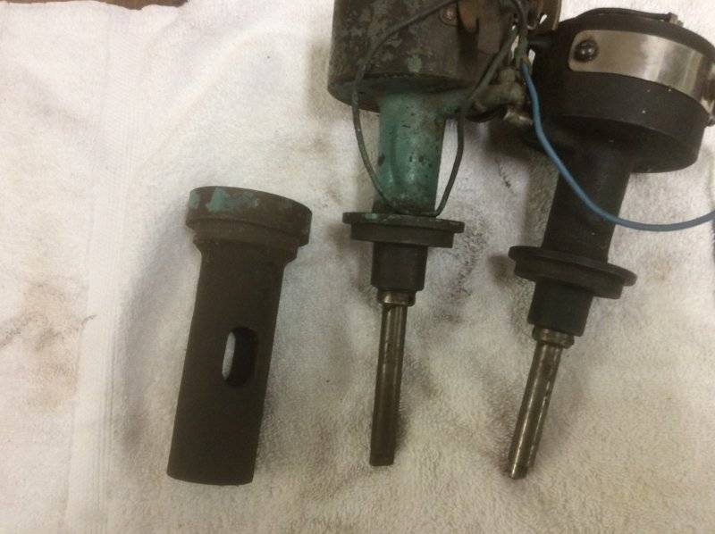

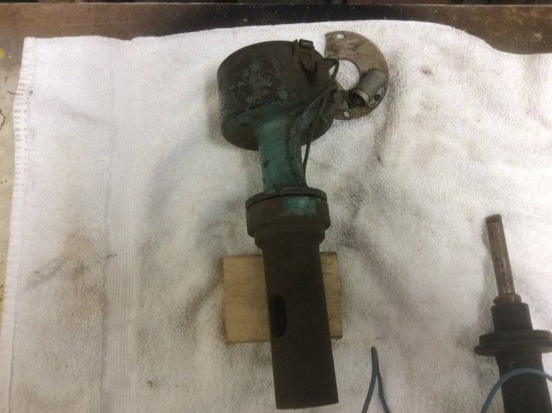

Chrysler Marine had sleeve that went in distributor hole to hold oil pump drive in place. The distributor had a longer shaft. Believe the motor ran "backward" so it would push up on the distributor so they needed the sleeve. I've got one someplace. Friend of mine got 2 413 marine engines junk rotted blocks from sea water. He took the marine stuff and gave me the rest. Engines had adjustable rockers and forged cranks.
Pictures of the marine setup. First on the left is the sleeve that goes into block. 2nd is the marine dist, note long shaft. 3rd
is dist and sleeve together.

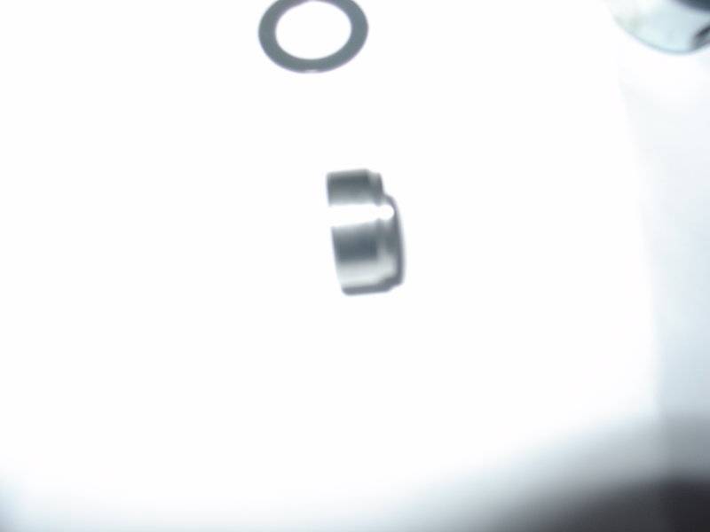

Don't use them they severely limit the oiling to the distributor shaft use a small one about the size of the oem one. I have a bunch I would sell one to you,
Really?
Can you show me you’re one’s ?
Thanks
You can definitely see the picture that it is wider than the shim so little oil is getting to the shaft. Usually the ones I get in like that the bottom bushing is at their limits and I change them if it is a decent core if not it is parts, some of those bushings are not cheap!
as mentioned, I know some ppl have used even garden hoses to this issue ( all allong the shaft ). Cheaper than that, imposible LOL. And can be trimmed out as whished. Aside offers some cushion
Wow never heard that one before does it stand up to oil?
I have had that jumping with everything new but just the oil shaft. Just that I have more problems to fix before get into that.
