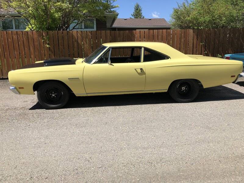

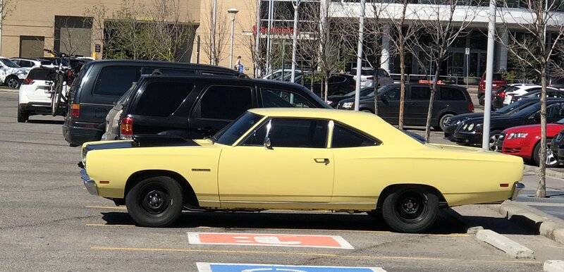

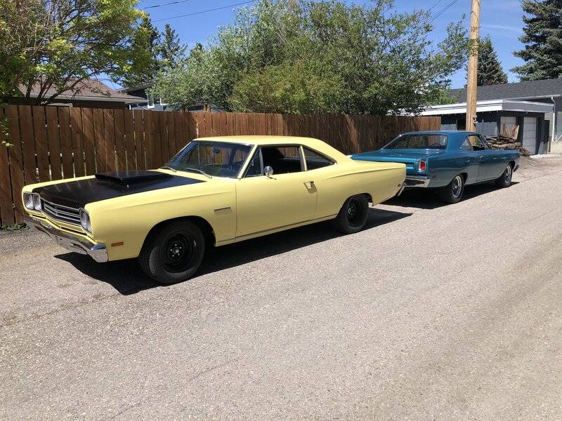

I recently finished putting this car together and it has KYB gas adjust shocks on it. Well with only 500 miles on the car still, I’m sorting out what ever pops up including clunks and rattles here and there. I’m finding that these shocks are super harsh and really feel road cracks and bumps etc. Kind of jarring really. They hold car up well cornering but this car is built mostly to go fast in a straight line not corner anyway...
Wondering if others aren’t liking these shocks too and what you use for both descent handling and and a nice/comfortable ride?
Any recommends appreciated!

Bilsteins from PST. Great looking car by the way.
