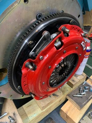

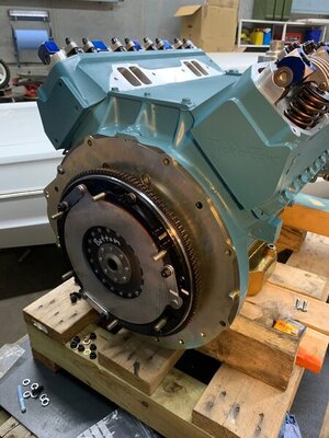

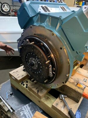

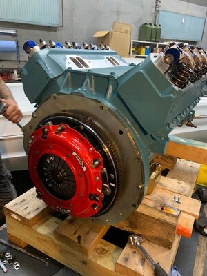

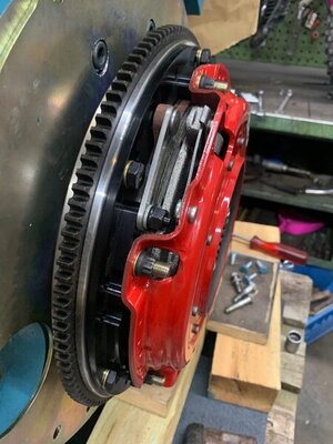

I drive the dual disc clutch with a 470 stroker.

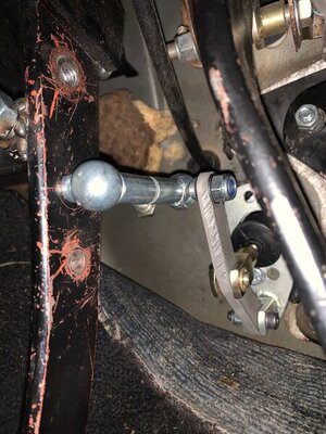

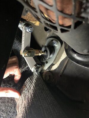

Previously I had 2 x centerforce dual friction. No comparison to the McLeod, which is worlds better. The operation is via hydraulics. The operation inside is done via a deflection which offers even more adjustment options and takes load from the firewall. Perfectly dosed, buttery but still tight enough for a good feedback.
IMG_3163.jpg IMG_3167.jpg IMG_3168.jpg IMG_3485.jpg IMG_3486.jpg IMG_6905.jpg

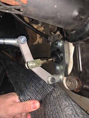

I'm looking at this pic you posted, and thinking how much nicer, more "solid", and less stressful to the firewall that must be:
My linkage to the hydraulic slave cylinder? is a compilation of parts, and ultimately just pushes a rod through a hole in the firewall. I'm not even sure how to adjust the "throw" that affects how much distance the rod moves the plunger in the slave cylinder. I know that distance is very important!
The way your linkage geometry is set up, all I can say is I have found "well known/reputable" and "skilled" people who have done work on my car, and my wife's GTO, and still leave me lacking or finding a setup like yours and saying "YES!" THAT is how it should be done!

I'm looking at this pic you posted, and thinking how much nicer, more "solid", and less stressful to the firewall that must be:View attachment 1203118

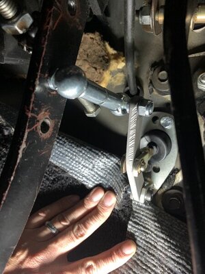

I also had before simply a direct connection from the pedal to the master cylinder. The problem was that it caused a lot of side load on the master cylinder due to the elliptical movement of the pedal. This caused abrasion and at high temparaturen jamming and noise.
I have changed the whole thing several times and tried different angles.
It was never good.
What I have installed here is a modified kit from modern driveline for a Mustang;).
You can find it here:
https://www.moderndriveline.com/sho...ang-lf-series-hyd-clutch-master-kit-700-bore/
I worked with 3 different cylinders, .625" bore, .700" and .750".

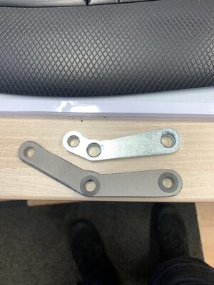

I ended up going with the .700" in conjunction with a longer homemade actuating lever. I swapped the supplied ball heads for sturdier ones and built a small reinforcement plate for the outside of the firewall.
Due to the longer lever, there is a lot of load on the lower suspension point of the lever, which I will soon support upwards.
Attached are some more pictures.
If you have any questions just write me.
