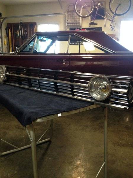

Curious if this could be done on these parts since they are prob aluminum? Any pics?

I saw a 67 Coronet 500 at a show in Georgia several years back that (per the owner) all the side trim was stripped, polished, chromed, and the paint detailing done. I didn't question the process, but it looked awesome.

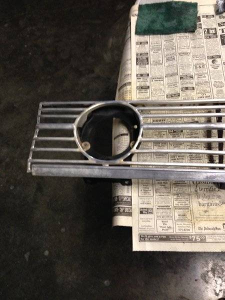

deanodized mine with heavy duty oven cleaner in the yellow can and scotchbrite pad. Don't get in a hurry, it's a mutha!
