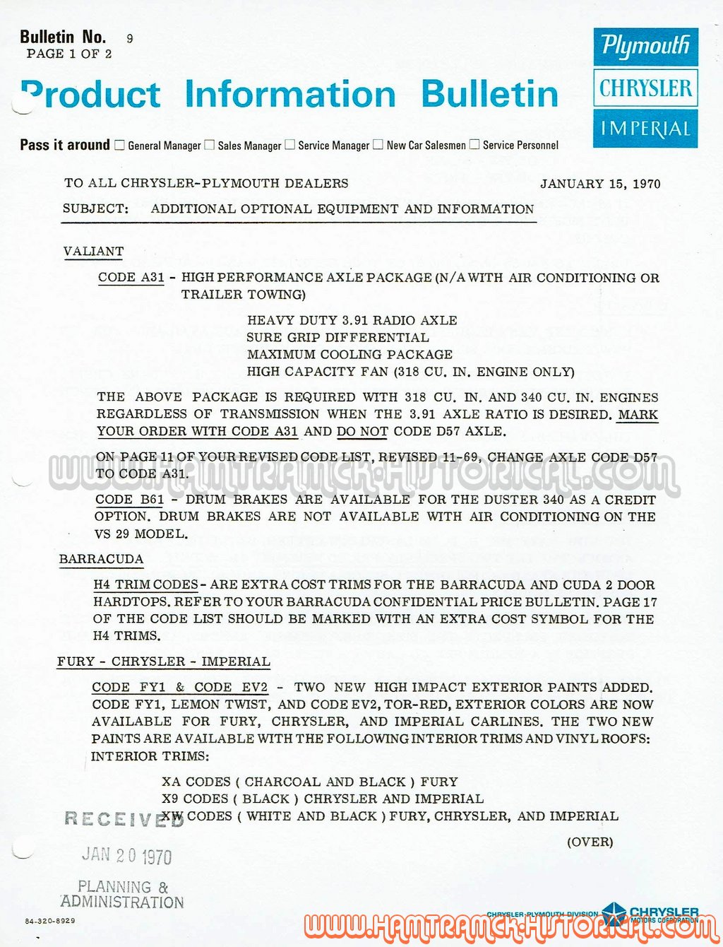

The 3.91 with auto is not shown in the ordering book printed at the beginning of model year. BUT there are all kinds of options and special packages added and deleted throughout the model year.
Your 3.91 with automatic is option code A31. And available here: https://www.hamtramck-historical.com/images/PIBs/1970/1970 Plymouth pib 9 pg1.jpg
These Product Information Bulletins are lesser known and harder to find. Barry has been collecting them and sharing them in his Hamtramck Historical site. There’s still many that he don’t have record off.
In early 2000’s these Bulletins weren’t shared publicly like they are now. And the list of them is growing.

I just pulled up the window sticker and on the top left (color code) 09 is indicated.
And yes, A31 high performance axle package is indicated.
