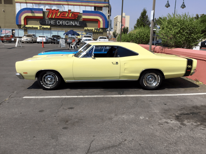

I think Dennis H put them on his R/T and liked what they did for his car.
Summit truck. Inserted one each side. All the same hardware used IIRC. inexpensive. Just over one inch gained. Perfect for my application.
