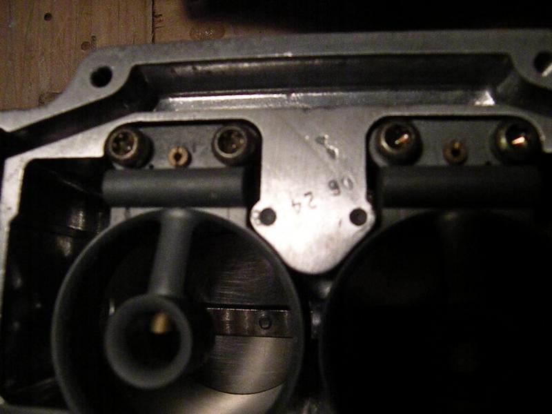

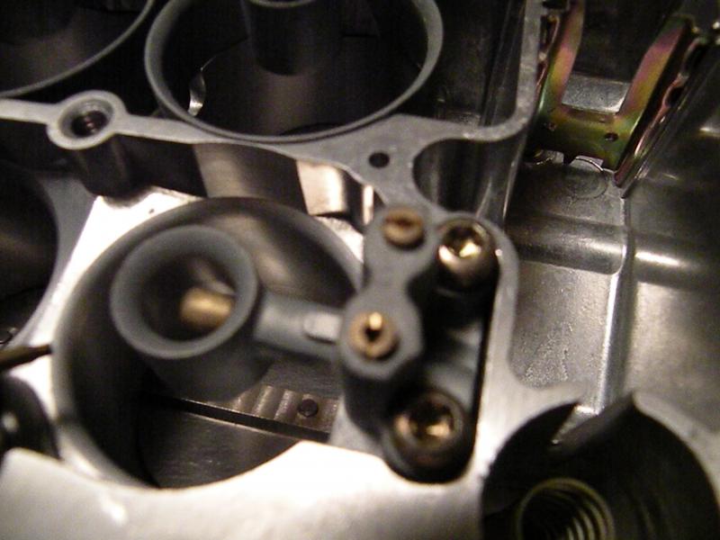

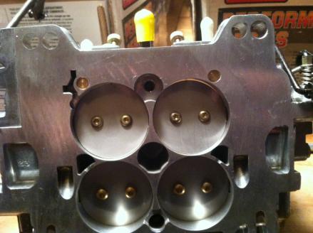

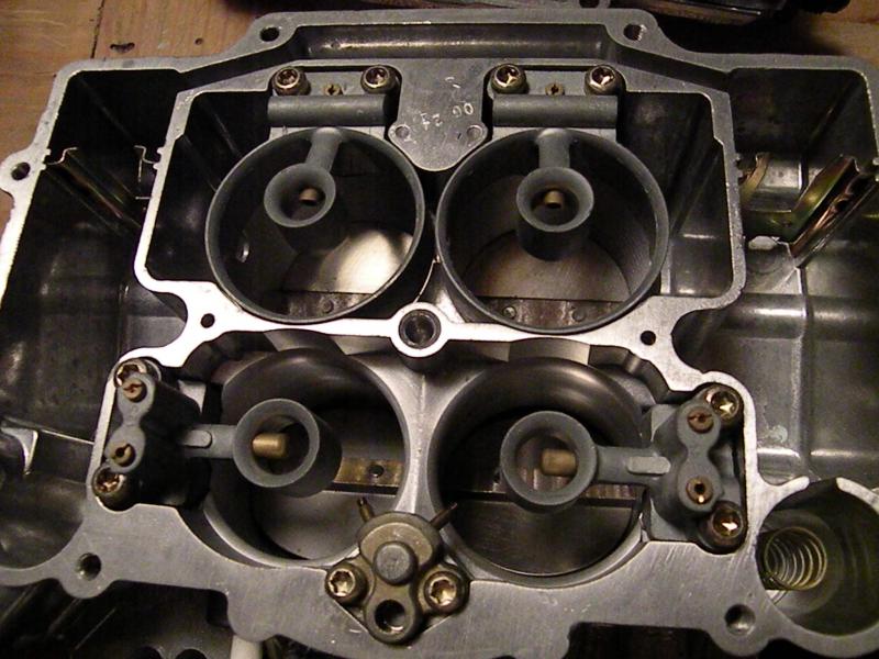

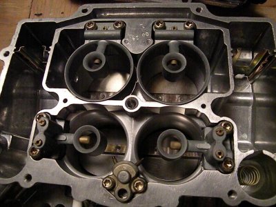

Ok I tore into the new Dale Cubic Carbs and got pics of them. I had to rejet them As they were 101 in the secondary's and .113 in the primary. It has orange metering springs and 6847 metering rods which I left in to try but I usually run 7147.

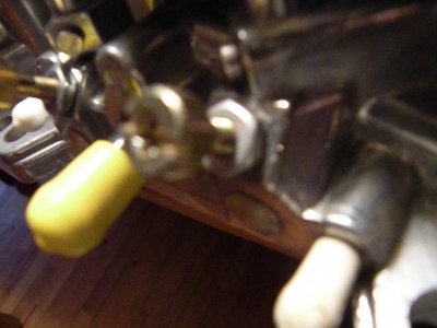

Also Dale Cubic removed the air mixture springs and put in locking nuts to prevent damage from the very thin walls where the air mixture screws thread into. He said if I blow threw the casting, the carb will be junk.
I had to cut off the GM linage so it will fit on top of the tunnel ram intake.

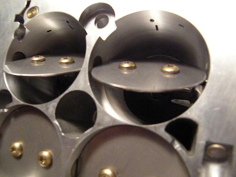

Check out the massive bore size underneath and the custom made butterflys & the locking nuts sans springs on the air mixture screws.

larger throttle bores/streamlined shafts, opened up venturi, and what looks like holley air bleeds. looks like the primary main bleed tubes are gone. there's another idle air bleed on the side of the primary clusters; was that changed? get the calipers out and measure the throttle bores and venturii.

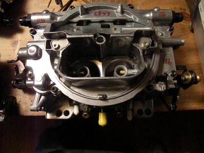

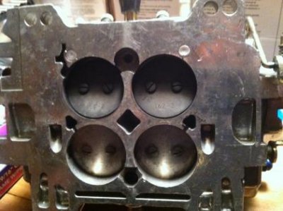

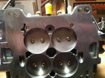

Kevin, here are the 2 for comparison .OOTB Edelbrock and the Dale Cubic Edelbrock
