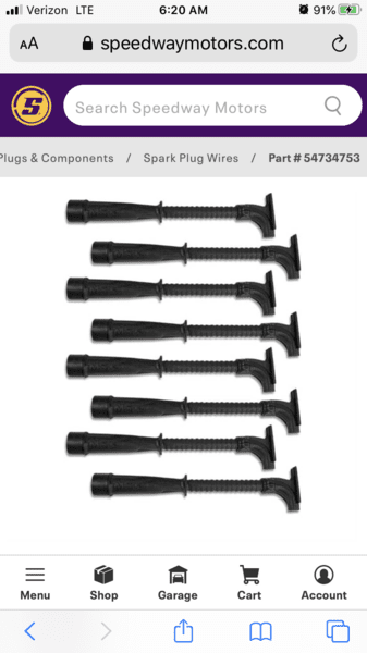

I run the msd hemi tubes and then add the stock tube seal to it. Much easier.

Agreed, not exactly factory looking but I use the same I just added the factory boot covers and cut the 90 degree portion off of the top.
I’m not sure I understand the MSD parts enough to venture down this road. What difference does the plug tube make with regard to getting the rubber insulator pulled lose of the plug? The MSD plug boots don’t appear to have a tube seal on them? Just unclear as to their benefit.

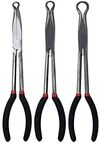

Would something like this not work? $30 at Harbor Freight.

They have a "T" handle design to pull them up from. As I show pictured on mine I added the boot covers.
