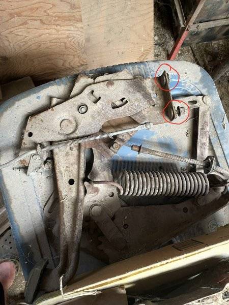

Anyone reproduce the studs for parking brake assembly to firewall?

I know lots of these break off when being removed. Does anyone reproduce these? Or know where to buy anything similar? They should be easy enough to change out instead of replacing the whole assembly.
Just use a common weld stud. 2 small tacks on the head and you are done.
