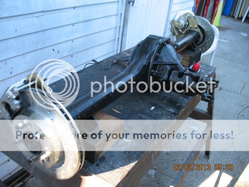

Doctordiff has what you need at a good price. I have the 4 wheel kit on my car and the repopped master cylinder with booster from Piratejacks.
I just ordered wilwood 4 wheel disc for my charger they have the parking brake on the rears . I got them at a very good price from elite vintage auto out of n.j. he was cheaper then everyone (I don't like eBay so I didn't check there) and he's a huge mopar guy you Just call him and he asks a few ?'s about budget and what your car has and gives you a few options ,he sent me the links to each set to look at and was very helpful answering my ?'s as this is my first disc brake conversion. Good luck if you want his info just p.m. me
