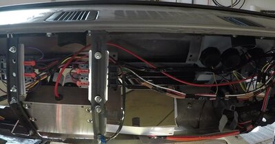

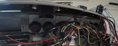

Yes. Full custom dash with speed hut gauges. using bulkhead connector.
Don't tape up the wires like I did here for mockup. most of that was removed because we kept adding and re-routing wires.
This is on Alaska Mikes '69 Coronet.
The ron francis kit is pretty nice. all GXL type wire, I think mostly stock gauge wire 16 AWG for most of the circuits. The wires are labeled / marked but the colors are more generic, so wire colors not same as Mopar. The kit does not have the correct connector for the turn signal harness. They give you a ten socker Packard 56 type connector to replace the stock (Molex?) connector.
This cluster was all custom, and only original type switches were ignition key and light switch.
The rails above the fuse block have relays on them the for the hazard switch, and 3-speed wiper motor.
Wiring would have been easier if the stock wiper and hazard switches were used.

I used Ron Francis kit to rewire the entire 69. It was very complete and well done. The only thing I didn’t agree with on their kit it it stated use their schematic as things changed over the years. I ended up needing to use both old and new schematics to get the job done. Comparing systems as I installed the new. Other than that which really wasn’t a big deal it went very smooth.
